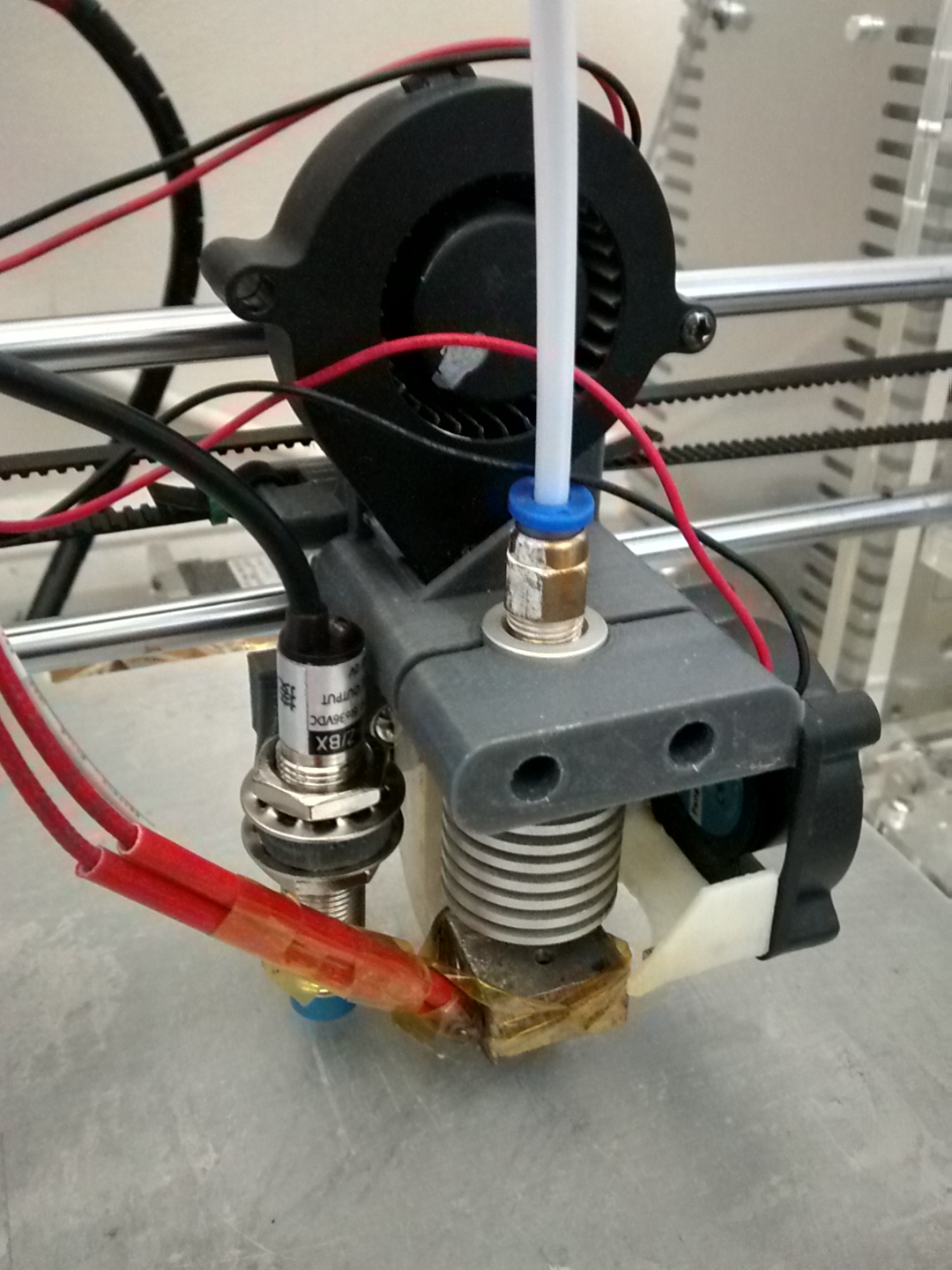

After over 2 years of using the Sunhokey acrylic Prusa I3 I upgraded it
After over 2 years of using the Sunhokey acrylic Prusa I3 I upgraded it with an aluminium bed, inductive z sensor, custom designed carriage and managed to upload an optimized Marlin. Took me a few days but it was worth it. Even the print area is bigger because of that tricky carriage design. Auto bed levelling is also quite awesome.
The weird thing was that I had to use two 10K resistors for the voltage divider on the inductive sensor to not to go over 5V with the signal.
If you are hesitating with the upgrade, don’t. There are tons of info on the internet, just go for it.
