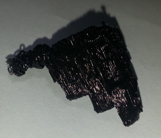

After owning my Printrbot Simple for over a year, I have finally had the time to sit down and start calibrating it, resulting in the rather badly photographed second print. Apologies for the quality of the images. All in all it is a slightly better print than my first attempt with clear filament, but there is a lot of room for improvement.

Looks to hot and could use a fan to cool the print for starters.
It has a fan, and I have already tried to lower my indicated temps to 185 degrees, however it automatically defaults to 200 when I start a print, and I can’t seem to get that to change no matter what setting I adjust.

Getting better, still looks to hot.

Like @Wayne_Friedt said it looks too hot. Slow the speed down and drop the temp on the hotend if you are running over 200c. But don’t drop it a lot, maybe just 5 c. I don’t want to copy what the others have said but a fan is great as well.

You can see the result of the varying bed height here, where the bed is a good distance from the hotend you can see it’s relatively smooth.
As the distance between bed and hotend increase it becomes quite wiggly, and imprecise.
