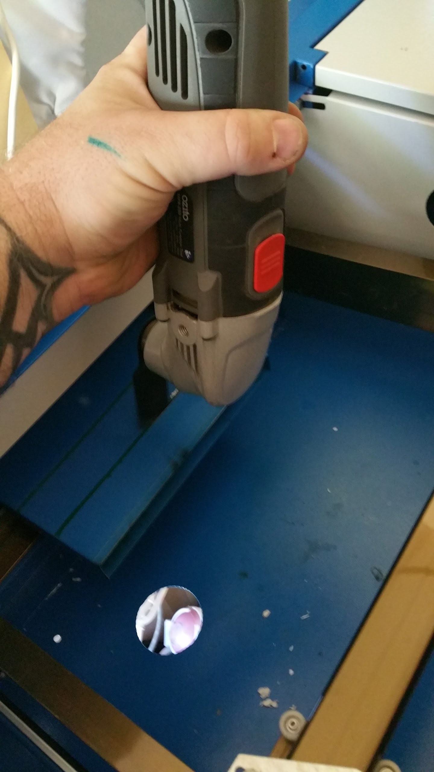

After putting a bolt in each corner and setting at the right hight i had to cut the end from the vent so the bed would go back in
Pretty common, I did the same to my first machine. To be honest I wish I’d taken the whole vent out!
My latest machine has four screws holding the vent in. Probably the only thing that is better lol.
Yeah my vent is welded in or i would have taken it out
Yeah my first machine is welded too, can’t even easily cut it out from behind… Such a pain in the arse lol!
