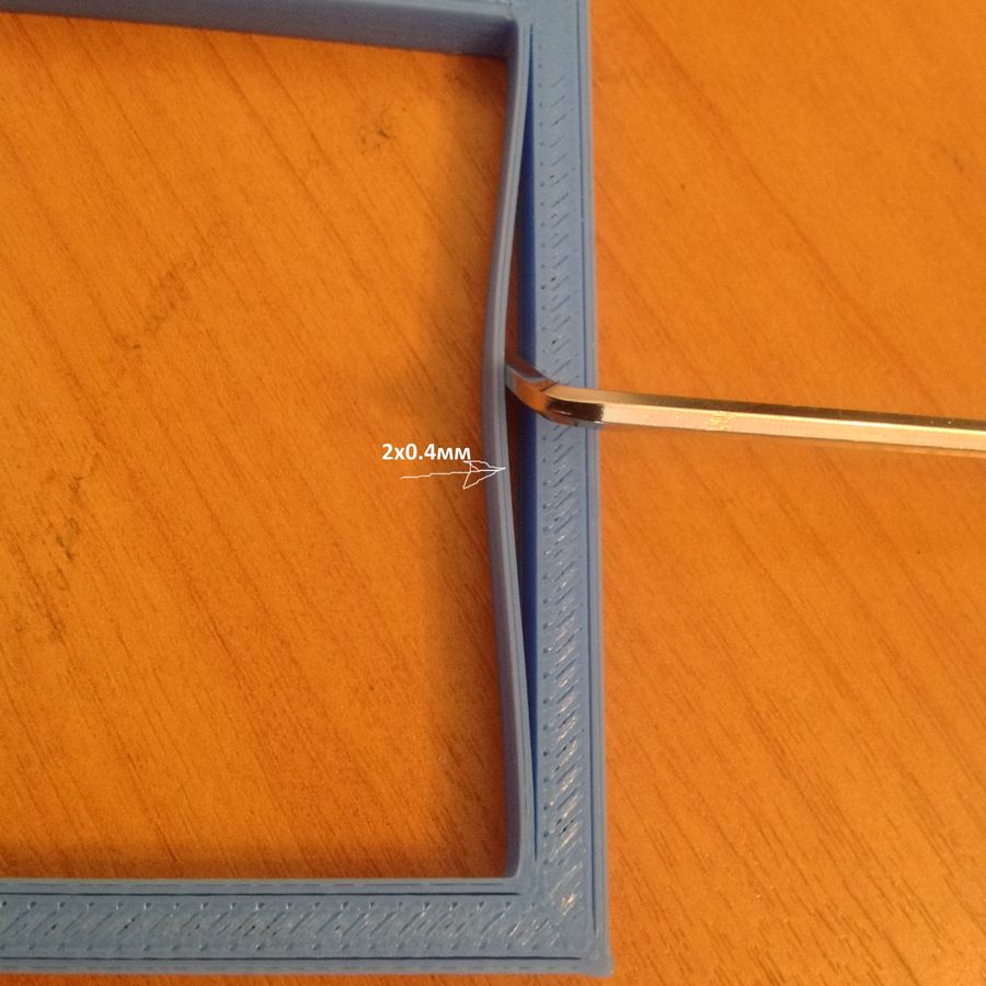

After some experiments, I finaly found proper printing settings. But there is one problem I can’t solve (yet?). Seemls like external layer of my print not “glued” strong enough to the “filling”. On which setting this depends? I’m using Sli3er.
Infill/perimeters overlap, under advanced. 15% is default.
You may have slight underextrusion tough, as your top layer has small gaps.
Thankks, will play with this.

This is a mater of how the material cools and how fast you print. If you print all the perimeters very slow (about 30mm/s) It is no problem. If you start printing the inner perimeters faster and the outer slower they tend to separate.
OK, so I set overlap to 20% (from default 15%). Now it seems to be OK, right?
Also I noticed my PLA thread is not 1.75, but rather 1.5mm, so I changed this setting in Sli3er too (does it actually have any effect on print settings? Not sure).
Changing the filament size in Slic3r absolutely has an effect and is very important. In your case it will mean that much more material is extruded, and it explains why the first print was underextruded. I would try to set overlap back to 15%.

Vladimir, i would be careful playing with perimeters for a bit. You had bad feed rate before which you fixed by switching from 1.75 to 1.5, but it is very likely still not properly calibrated.
Most prints should work with 2 perimeters and 15% overlap. If they don’t, look at the feed rate first.

It seems like you did things in the wrong order but still ended up with a working print. If you wan’t to better calibrate your printer, first calibrate the extruder, make sure the filament diameter is correct, then check infill overlap. Also, it looks like your corners are a litle wonky; the outside corners buldge out and the inside corners buldge in, is this a design feature or a problem with the print?
This is problem with print, yes.I don’t know how to fix it yet. As for layers, as I mentioned before, I returned overlap to default (15), and just set correct (real) filament diameter, and this problem with layers is gone. Also I don’t know how to “calibrate extruder”. There is some topics in the Internet, like measure 10cm of filament and make printer to feed exactly 10cm into extruder, and calculate the difference, and write it into EEPROM of the board. But since I can’t write in EEPROM for some reason, I can’t do it yet…
