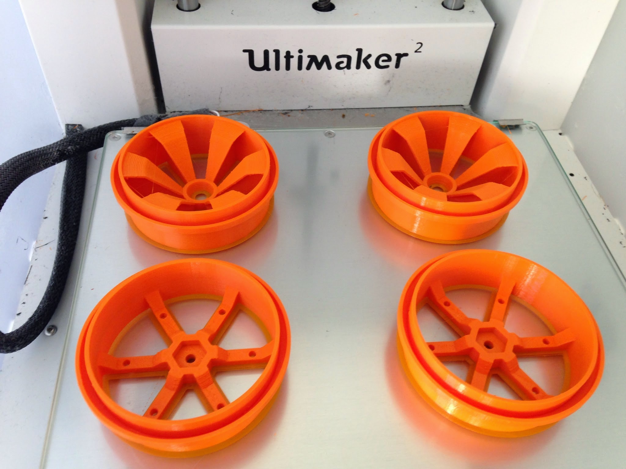

After some modification on the rim and split in to part they are more
After some modification on the rim and split in to part they are more easy to print, no support needed and better looking surface :slight_smile:
both part can be stitch together with M3 screws. The rims are printent with PLA layer 0.2 /230C/ 50mm/s. It’s possible to print wit 80mm/s but has an impact on the surface.

did you print a whole rim at a time, not by layers? and care to share the stl, please?

Yes I printed a whole rim at time, the surface will be better because you haven’t start point at each layer.
