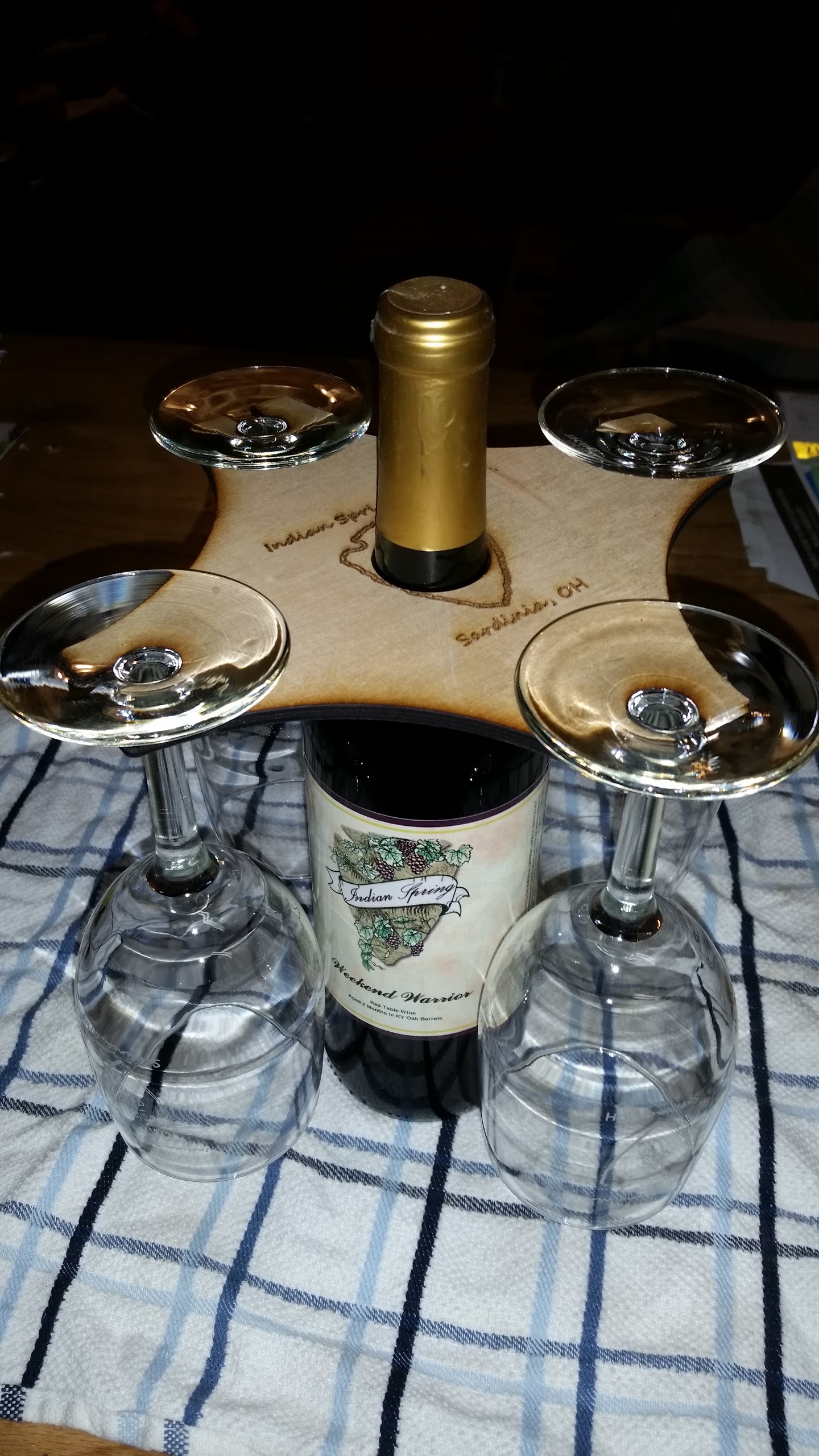

After some time playing with alignment and laser draw I was able to make my first useful project.
Very Nice project
I was really surprised. The k40 cut 1/4" Luan at 10mm/s, two passes, and 12ma power.
My $3500 40w at work would struggle with this.
Clever. Looks nice.
