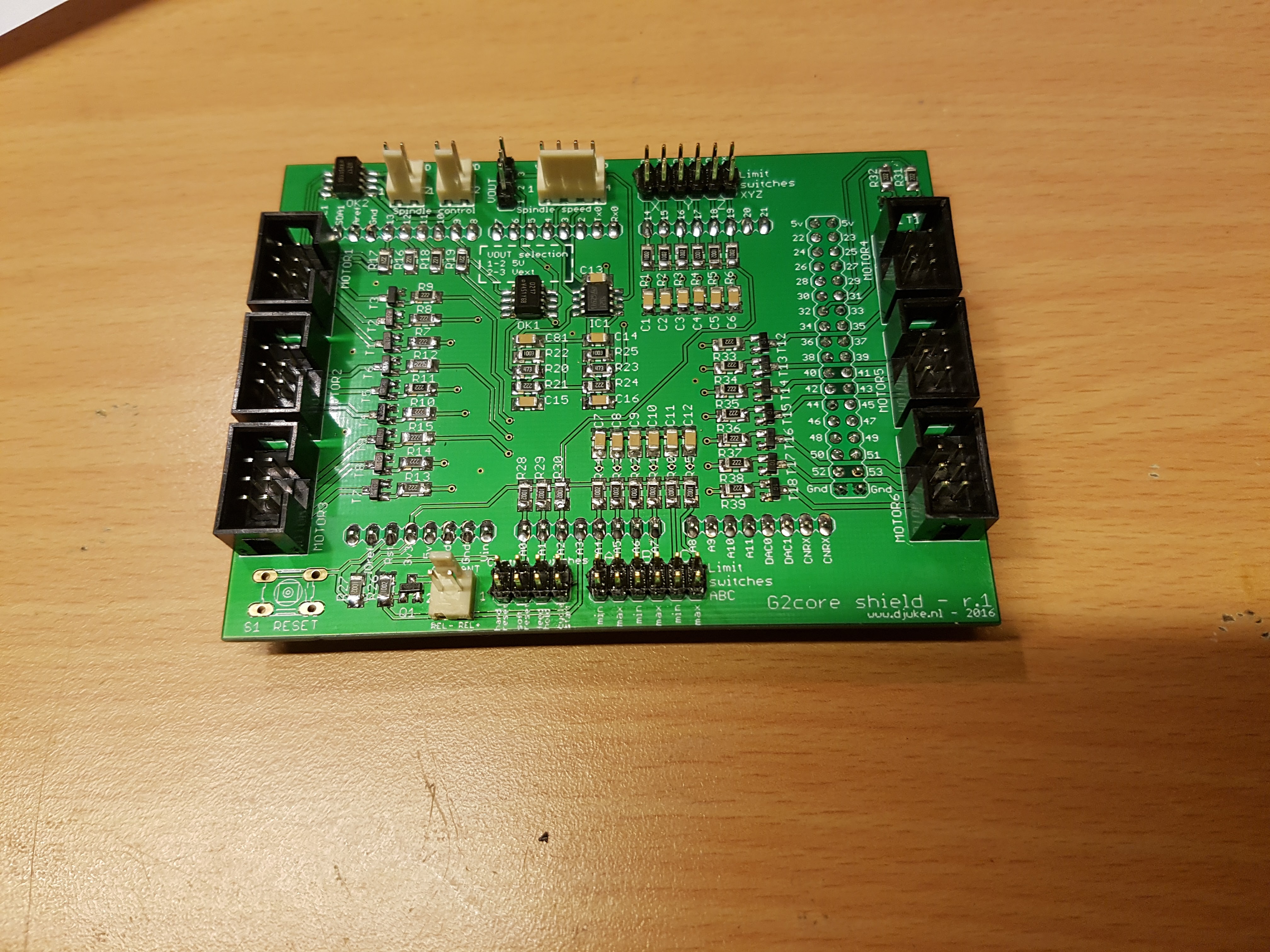

After some weeks, the PCBs of the g2core shield arrived. Quickly mounted the components and tested that all 6 motors could be used. Also the coolant and spindle enable are working nicely.
For some reason, the spindle direction stays off all the time, anyone knows if g2core switches this properly?

The spindle direction should be switching properly. It might not be pinned out properly in your board files.
If you look everything over and find that it’s generally not working please, then open an issue on github and we’ll take a look. Also be sure to test against the dev branch if you haven’t already.

Btw, I measured the spindle direction directly on the Due output, so shouldn’t be a problem in my board. I will check the dev branch though.
Question for +Synthetos I based my g2core shield pinout on https://github.com/synthetos/g2/wiki/Arduino-DUE-Pinout-for-g2core, where the spindle direction is connected to pin13. After checking out the g2 source code, I noticed that the Due+gShield pinout (in gShield-pinout.h) has spindle direction pin set to -1, and 13 is commented out.
Can you give me any direction why that was not set to 13 by default and what would be a good way to proceed?

Hey, @Menno_de_Graaf
Pin 13 is reused to use it for PWM Signal generation of NEOpixel RGB Pixel support.
see:
_MAKE_MOTATE_PIN(13, ‘B’, 27); // D13, PWM13, LED Indicator
source: https://github.com/synthetos/g2/blob/f1d54d19145d41c840d276ed0a603ca1a6bcd796/g2core/board/ArduinoDue/motate_pin_assignments.h
I reused D58 and D59 for Direction and enable to get around…
Hi @Andre_S thanks for your comment. My understanding is that motate_pin_assignments.h only defines the pins that are used on the BASE_BOARD (so the Arduino Due), not their functions/mapping. Then gShield-pinout.h contains the pin mapping, so which pin is mapped to which function.
In the source code I don’t see the references to the Neopixel RGB Pixel support you mentioned. If I simply adjust in gShield-pinout.h the line:
pin_number kSpindle_DirPinNumber = 13;
The spindle direction is set properly for the gShield BOARD. I was just wondering why that is not done by default.
Could you give me some direction, where in the source code D58 and D59 are mapped to Spindle direction and enable. In my understanding these are mapped to Amin and Amax on the gShield.
Shouldn’t M3 and M4 as spindle Start be enough to Set direction? I measured the Output Pin and it changed from Low to high, when switching. M5 is spindle of
Using the latest g2 edge, it does not set a different spindle direction on pin13 using M3 and M4, which corresponds to https://github.com/synthetos/g2/blob/edge/g2core/board/ArduinoDue/gShield-pinout.h. Which version are you using?
@Andre_S That should be pin 13. I just opened an issue for this. https://github.com/synthetos/g2/issues/229

Tests with the board showed that it works nicely, although not all connections are supported by g2core yet. I still have a couple of them in stock. They will be for sale with SMD components premounted.
