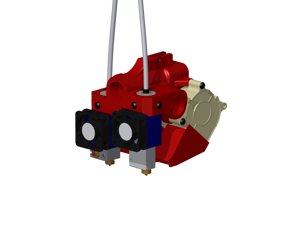

After struggling with PETG on an E3D Volcano I decided to revisit the idea of a dual V6/Volcano carriage for the Herculien. Waiting on some brass inserts (no more captive nuts) before I can test it. Oh, and I need to buy a V6 now…
The plan is to mount the hot ends using threaded brass inserts and some M3 screws to hold it in place. Should allow for adjustments of nozzle heights over 1-2 mm as well as easy removal of the hot ends and access to the bowden pushfit connectors. Designed to print without supports.
Just a thought, have you considered using an E3D Chimera with two volcano heads, one with a small nozzle diameter (0.4) and the other with a larger diameter (0.8)? That is, only if your problems stem from the larger diameter nozzle as the source of your oozing problems
@Ishaan_Gov The benefit of the Volcano is the extended melt zone, not just larger nozzles. This allows for much faster speed with traditional nozzle sizes. However, it’s a lot more work to dial in the right settings
