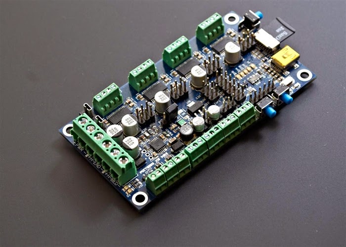

After talking with a bunch of you on here I ended up buying the Azteeg X5 for my new printer. I’m not sure which steppers motors to get to take full advantage of the 1/32 steps it can handle. I was looking at the nema 17 42BYGHM809 but cant see anything about 1/32 steps.
The M809’s work just fine with the 8825 driver chips on the x5. I’ve run this combination (DRV8825/M809) for a while with zero issues. The 8825’s are great chips.

1/32 applies to the microstepping rate of the driver. The 0.9 motors have 400 detents. This is full-step. But the DRV8825’s can microstep down to 1/32, which means that at 1/32 those M809’s will have a resolution of 12800 steps per revolution instead of 400 steps/revolution.
oooo ok that makes since thanks @Matt_Miller
micro stepping is totally independent of the stepper motors, it is a way to control the current that gets fed to each coil allowing for intermediate positioning of the shaft between two full steps. I think you will like the Azteeg X5

Well that’s the one I bought. Most Nema 17 have a step angle of 1.8° = 200 steps per rev. This one has a 0.9° step which gives 400 steps per rev and should give you much finer control. Also if you combine it with a set of G2 pulleys and timing belt, not G2.5, gives even better precision.
Enjoy and good luck
Probably won’t want to use the 1/32 stepping with .9 steppers. Micro stepping is good for noise reduction but has it’d inaccuracies due to not being able to efficiently hold between steps. The .9 steppers will help this and add 1/16 with them it’s the same as 1/32stepping but more accurate. Without limiting speeds much. The biggest problem with that is for every mm the machine moves you have to send step commands for hardware you have times 32. Increasing the code processed by the Arduino and probably slowing it’s processing
@D_Rob Idk Ill have to play around with it. The board is 32-bit so idk if it will have problems or not
X5 and smoothie can more than easily handle 0.9 steppers at 1/32 microsteps. I think the default max step rate is 100K steps/sec, and can probably go higher
