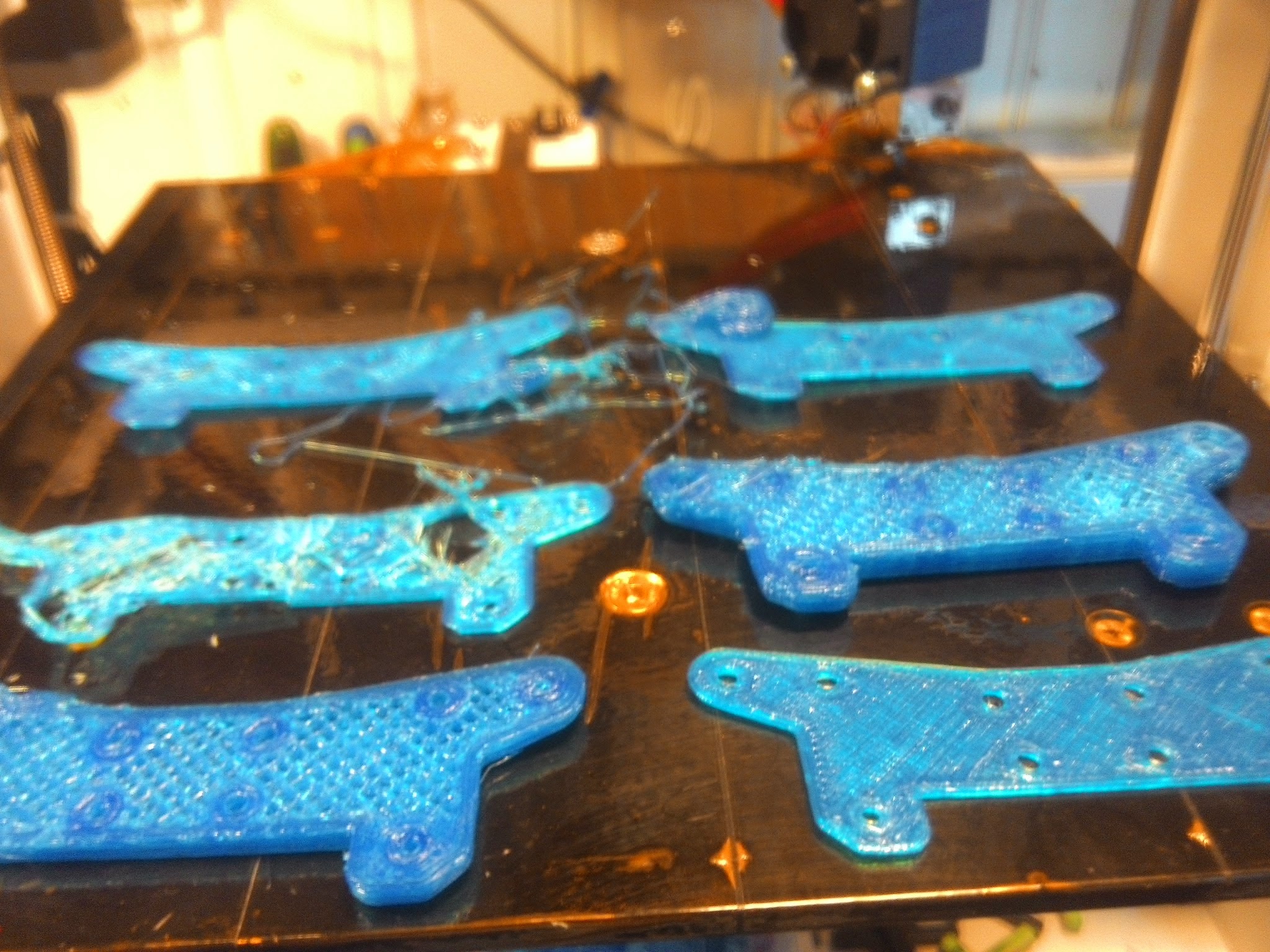

AHAHAH! I don't know what to say....
AHAHAH! I don’t know what to say… blame it on the printer!! :slight_smile:
What material did you use? Looks like wrong temp/speed.
sure, using PLA that I got from a friend. I think something is wrong with the temp… the printer suddenly stops mid print for no reason… :frowning:
What printer is it and what controller board?
rapidbot 2.0, original control board :slight_smile:
Put some painters tape on that bed, and if that doesnt help, boolean union some “mickey mouse ears” on the lift points.
If your too lazy for mickey mouse ears, check out the brim feature on slic3r.
