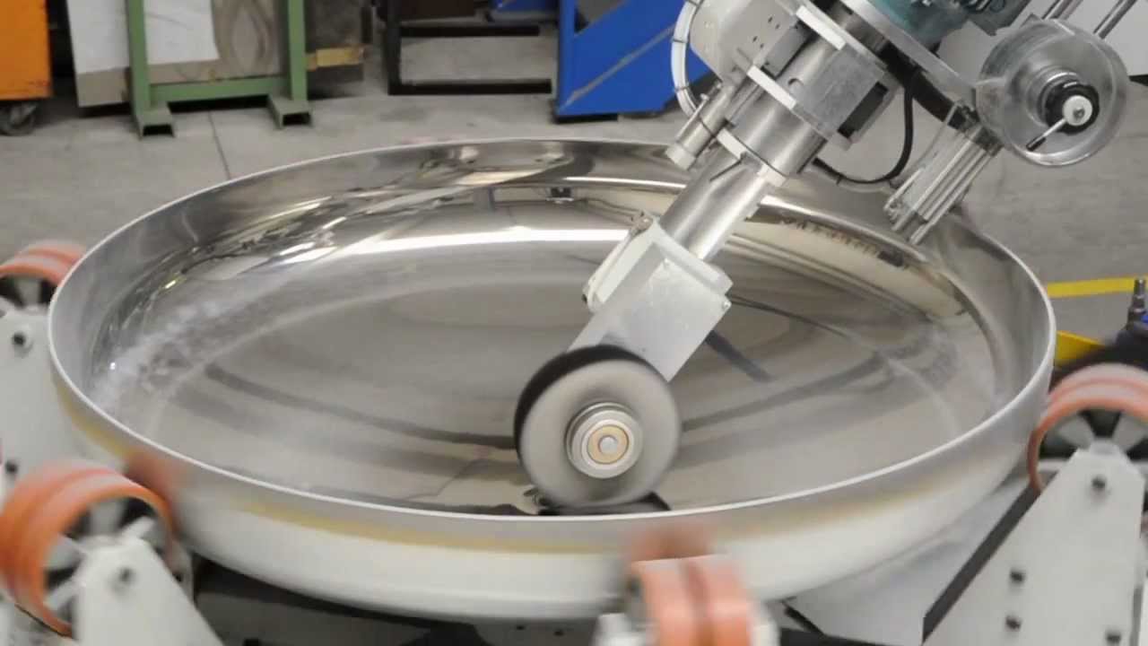

Just I want to know how can be possible to move a robotic arm using dynamic distances for example (AI that calculates the distance between objects that are seen from a camera) and send these distances to smoothieboard and move as result, or, grind and pulish stainless steel tanks, where the shapes of the tanks will not be the same: height and diameter change for each tank, and obviously, the purpose is to know which kind of software can help to “predict” (as near as possible) the path to grind and polish, and send to smoothieboard.
Just, some examples for grinding and polishing over stainless steel: KW150 Grinding Head Out Circular - YouTube
I have no idea what kind of software would do that. You would likely have to either find a company that sells aid software (I’m not sure how to search for them), or you’d have to code all of this yourself.
Smoothieboard listens/interprets Gcode, which is pretty universal “robot movement” language, so if you find existing software it’s likely to be able to output gcode/talk to smoothieboard.
