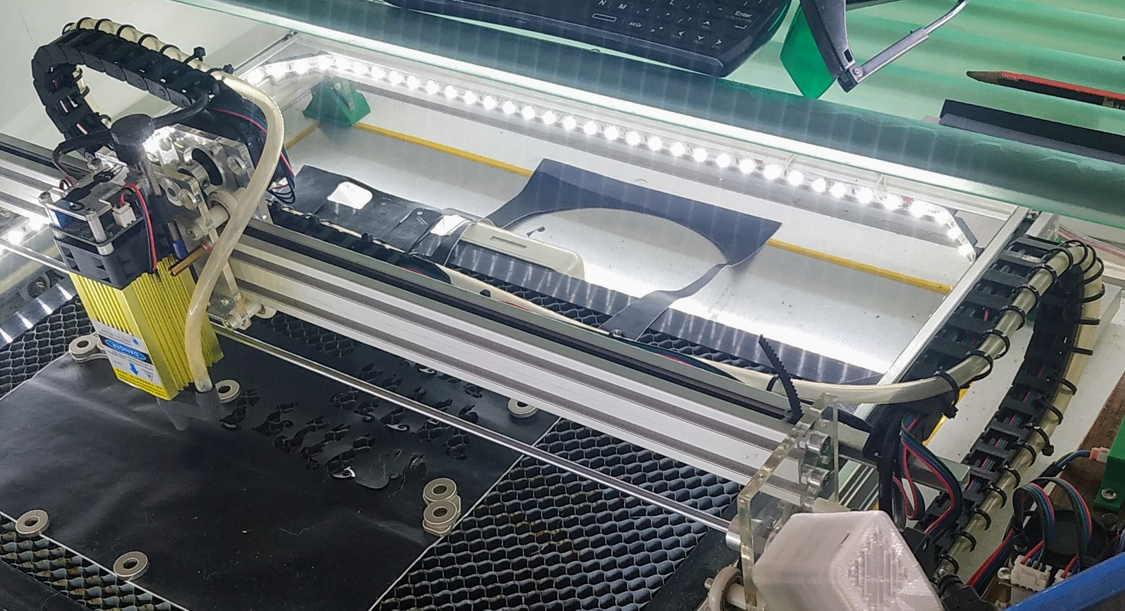

For what it’s worth; here is what I did:
I used the drag chains as a guide and spent a packet of small cable ties securing the tube to them. Dead simple, I was rather pleased with myself.

Thanks for feedback…actually tried this but felt it was adding some additional friction or drag to the head movement. So I’m replacing the drag chain with a wider /larger chain with open links which makes it very easy to route any air line plus my red diode guidance lines together. Using new silicone air lines. Also the air nozzle I have works but restricts the head movement in some cases so replacing it with a distributed nozzle from American Photonics. American Photonics also sells a reverse alignment diode that all screws directly into my stock K40 head . Not advocating or selling American Photonics but they have so great laser head upgrades for the K40! My next upgrade after this one is to change out my 1st , 2nd mirror assembly and head with Cloudray K series . American Photonics offers done optional focal length heads that fit into my Cloudray k series head and again with a reverse alignment system.
