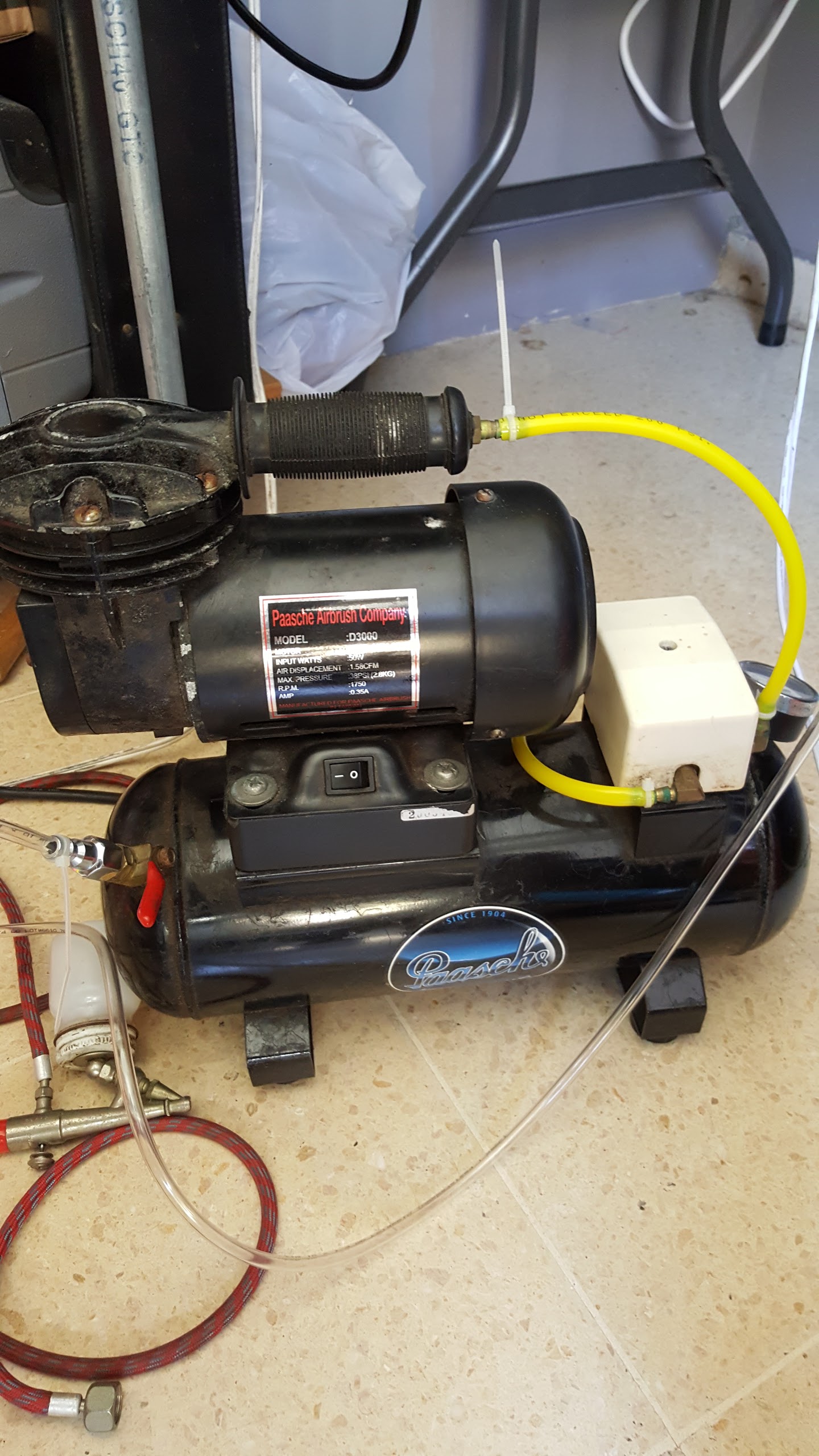

Air assist experts. I got this airbrush compressor here but it’s seems is not much use. Once I open the valve it blows all presume inmediatly and 0 psi constant after that. That’s on a 1/4 OD tubing. If I use the supplied airbrush pistol it can maintain about 20 psi. Tested at 0 psi it does help with the flames and smoke but nothing more. Should I get something else or is there a hack for this?
Stick a metering valve in the hose line. That’s all the airbrush is doing (more or less).
places a pneumatic flow regulator , and thereby control the air flow by the outlet nozzle . At the maximum nozzle flow , the pressure is 0, and at 0 flow rate the pressure is 7-8 bar.
something like this: http://fileserver.ingersollrand.com/images_tfm_complete//F01_l.jpg
or the most cheaper like this:
https://adajusa.es/reguladores-de-caudal/regulador-de-caudal-14-tubo-o6-unidireccional-orientable.html
