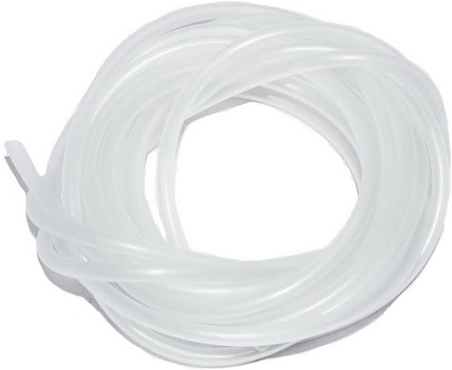

Normally you use a soft aquarium airline hose which is very flexible. Something like this:
