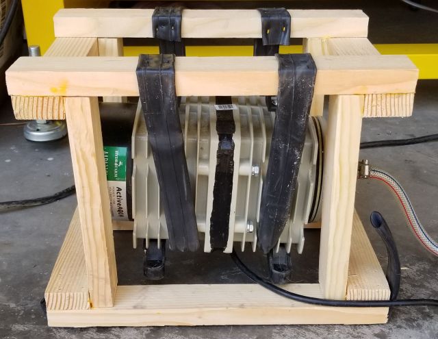

I am not sure if anyone else has the problem of their air pump walking all over the place but I do. It will cozy up to my bench or laser and make a hell of a racket. Well no more! I made a sling from an old bicycle tube. I also put the tube under the sling so it cannot walk around any longer!
Now I do not know it is even there anymore.
pump%20sling
Nicely done.
Nice … sling!
…but I just bolted mine down and all is good???
I thought the legs were isolated?
Due to the vibration, there were rubber skid marks everywhere!
I had the same problem with mine walking around on my garage floor. Threw a thick piece of rubber (~1/2") under it and now its stationary. I also threw some filter foam in an 8oz. plastic jar, drilled a hole in the bottom and pushed it on the air intake nipple. muffles the sound a bit more, even though I still prefer to turn it off between jobs. A RF relay makes that easy from across the room. Now I just have to wire it to the smoothieboard so it does that automatically lol
