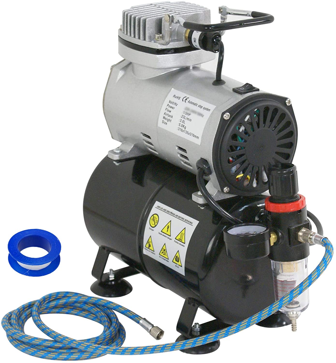

I was seduced by and got this one:
The price has moved up with tariffs and such; I got it for about $65 IIRC.
If you go this way, note well the comments about the fitting between the tank and filter/regulator. “Mike” sussed out the right stuff on the fitting that the manufacturer still doesn’t provide. Fortunately, the right fitting is available at McMaster Carr.
I use compressed air for other things as well, so this was a welcome “toy” compressor as well as providing air assist, even though it is a bit more expensive. Although some people on amazon commented on noise, mine was relatively quiet.
