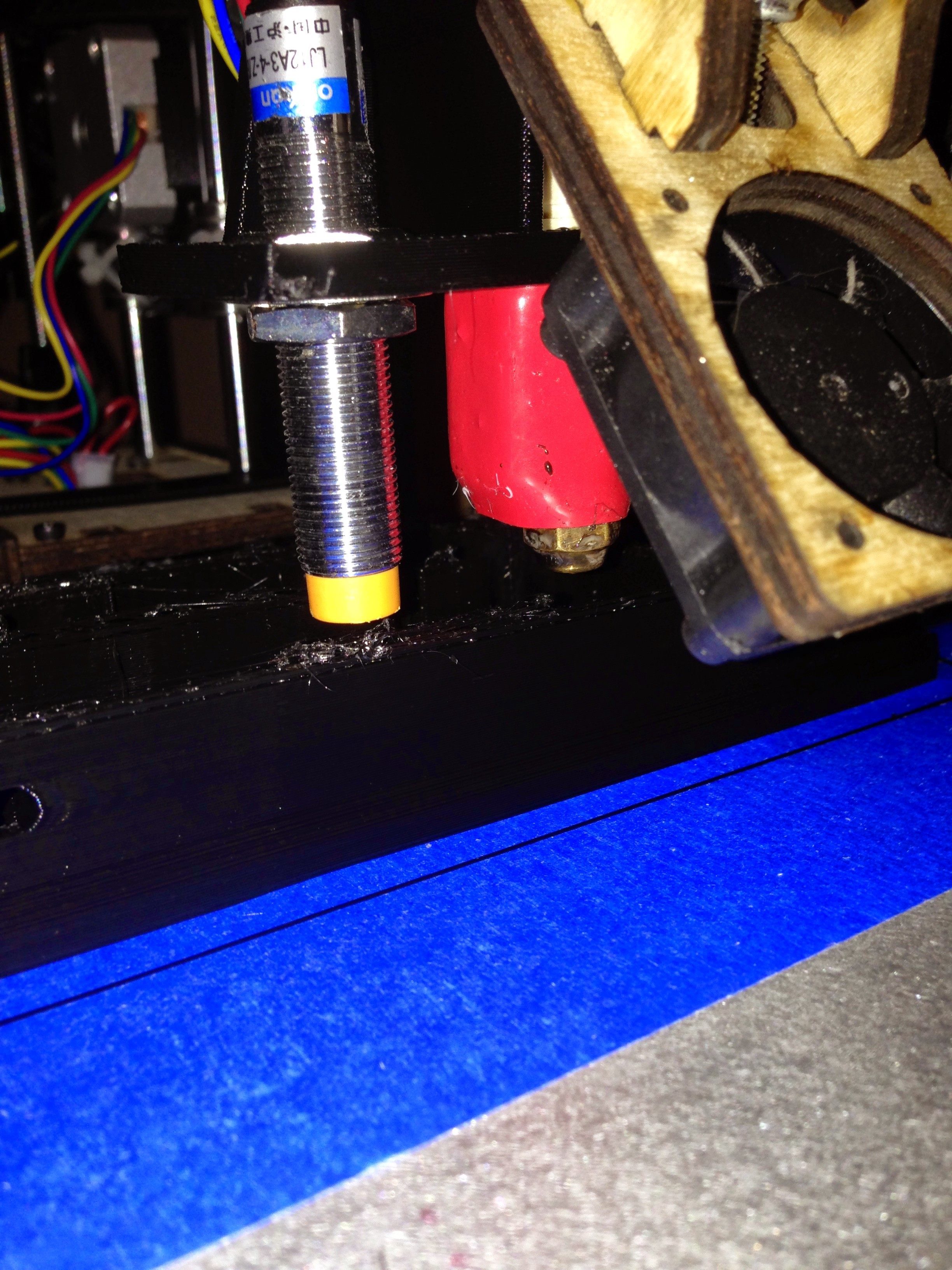

I made some adapters so they can still sit below the induction probe. So far it hasn’t been an issue.
I think it is a clog. The filament that gets out of the tip is much smaller than it should (0.4mm tip). I’ll swap it with a clean/new one.
