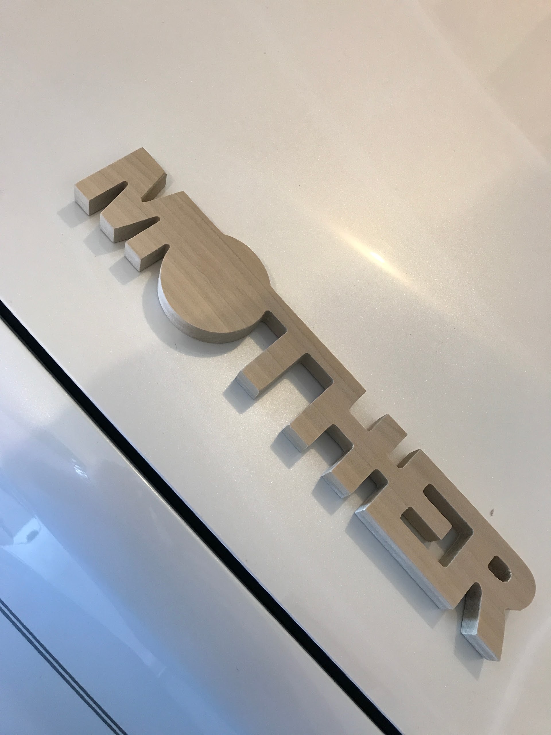

Alas. My first successful CNC cut in wood.
Nice! What software did you use for the design / gCode?
Fusion 360
Just forget to open that GCode file and add a little Zn to the start or you’ll drag a bit across the workpiece. I also like to add a close to the GCode that sends the spindle back to where it started from.
you don’t need to. just disable “use G53” in the TinyG postprocessor in Fusion 360 and you’re fine!
