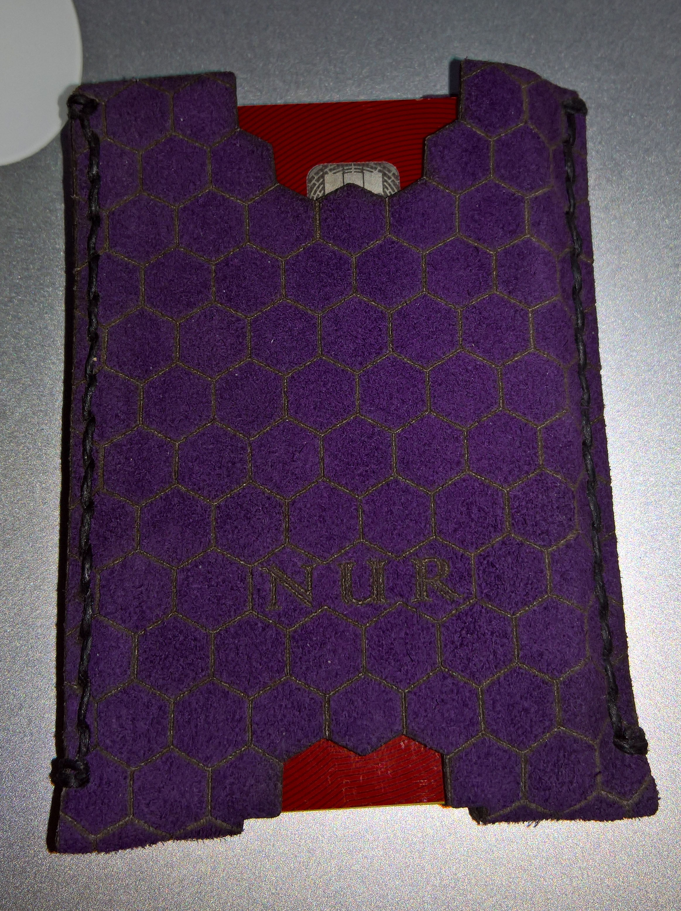

Originally shared by Yuusuf Sallahuddin (Y.S. Creations)
A test at a slim card wallet, made entirely with suede. Designed to fit credit cards & the largest “standard” business cards (i.e. took the largest international standard width, 91mm & combined with the largest international standard height, 57mm). So it should fit credit cards or business cards from anywhere in the world. It fits 8 credit/bank cards with reasonable ease. Possibly more could fit, but it would be tighter & potentially stretch the suede.
Laser engraved the beehive pattern & name. Smells extremely like burnt hair. As it is suede, I can’t use my usual method of dyeing/conditioning to mask this smell, so I’m thinking maybe requires some time stored in a container with something that may either absorb that smell or permeate the suede with a nicer smell.
Pretty happy with the results of this test. Turns out the dimensions of my design were perfect.

UPDATE: on the progress regarding the burnt hair smell.
@Alex_Krause @Susan_Moroney
So what I’ve done so far is place the piece into a small plastic takeaway style container for 2 days, with lots of crushed Lemon Myrtle leaves (gives a nice lemony smell). This didn’t seem to rid it of the burnt hair smell though. Although it smelled nicer, it still smelled of burnt hair.
So, then I’ve placed it in the same container, after removing the leaves, with some scrunched up newspaper as Susan suggested. It’s been in there about a day with that now & I do notice the burnt smell is less than originally, although still partially there. I will leave it another few days & see how it goes.
Try a layer of baking soda in the bottom of the container with a layer of news paper ontop of it
@Alex_Krause Righto, will give that a go & see if it helps.
