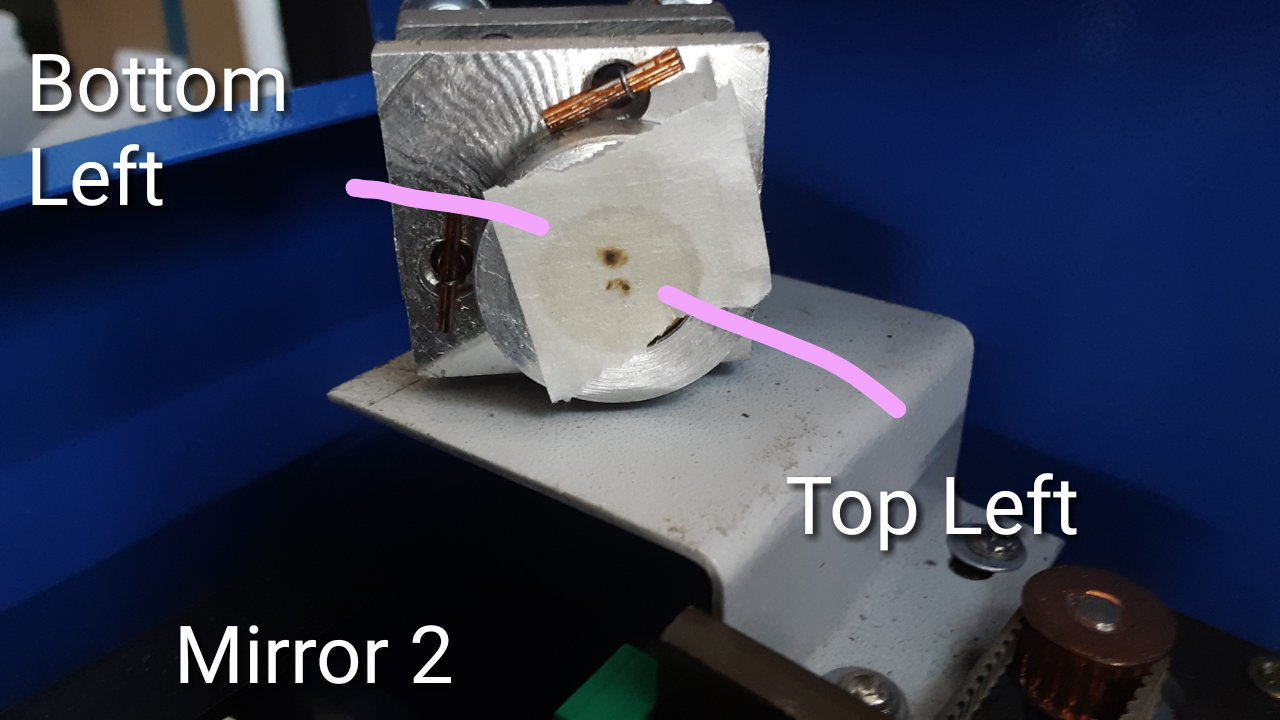

But if rotating the tube changes the alignment of the tube relative to the plane of the gantry and mirrors, wouldn’t that mean that the rotation does matter? I’m asking because what I’m currently dealing with is a situation where I believe Mirror 1 in my machine is too low and needs to be placed higher with washers or something along those lines. using the tape method on Mirror 2, the spot that burns is lower in the top left position than the bottom left position. Leading me to believe that the mirror is angled on an upward slope. When centering the mark in the bottom left position for Mirror 2 and checking the position of the mark in the top left position, it’s roughly a couple of mm lower. I’ve positioned everything as best I can and checked the levels on the ganrty itself.Mirror 1 is held in place by 2 screws on either side of the bracket, while mirror two is held by 2 screws on one side of it’s bracket. The bracket on Mirror 2 is not level, though. I can’t see the bracket being the source of the angle being off if everything else is level, unless I’m missing something or not looking at this the right way.
Pictures to illustrate the point…
Rotation will only matter if it changes the changes the positioning of the tube output. This is certainly a possibility. I was just saying that the laser tube itself doesn’t care about rotation.
If you put a piece of tape on mirror 1 and the spot is too high then then you either need to move the mirror up with washer shims or shim the tube up at the back bracket.
Regardless of where the laser is hitting mirror 1, at least to a certain extent, you should be able to align it to mirror 2 using the adjustment screws on mirror 1. Get the spots on mirror 2 to line up and see where that spot is relative to the center of mirror 2. If that alignment spot is high then your tube is possibly angled up.
I suggest following one of the alignment guides noted previously in this post.
I initially used the alignment guide to get where I am at this point. I get what you’re saying about the tube. I will have to look at the brackets for the tube to see how I would accomplish shimming the tube if that’s needed. What is the best way to figure that part out if the beam is hitting the center of mirror 1? Looking to see if I can cover an issue before it happens, in case it is a plausible issue (which I think it is).
Just put a piece of tape over mirror 1 like you did for mirrors 2&3
