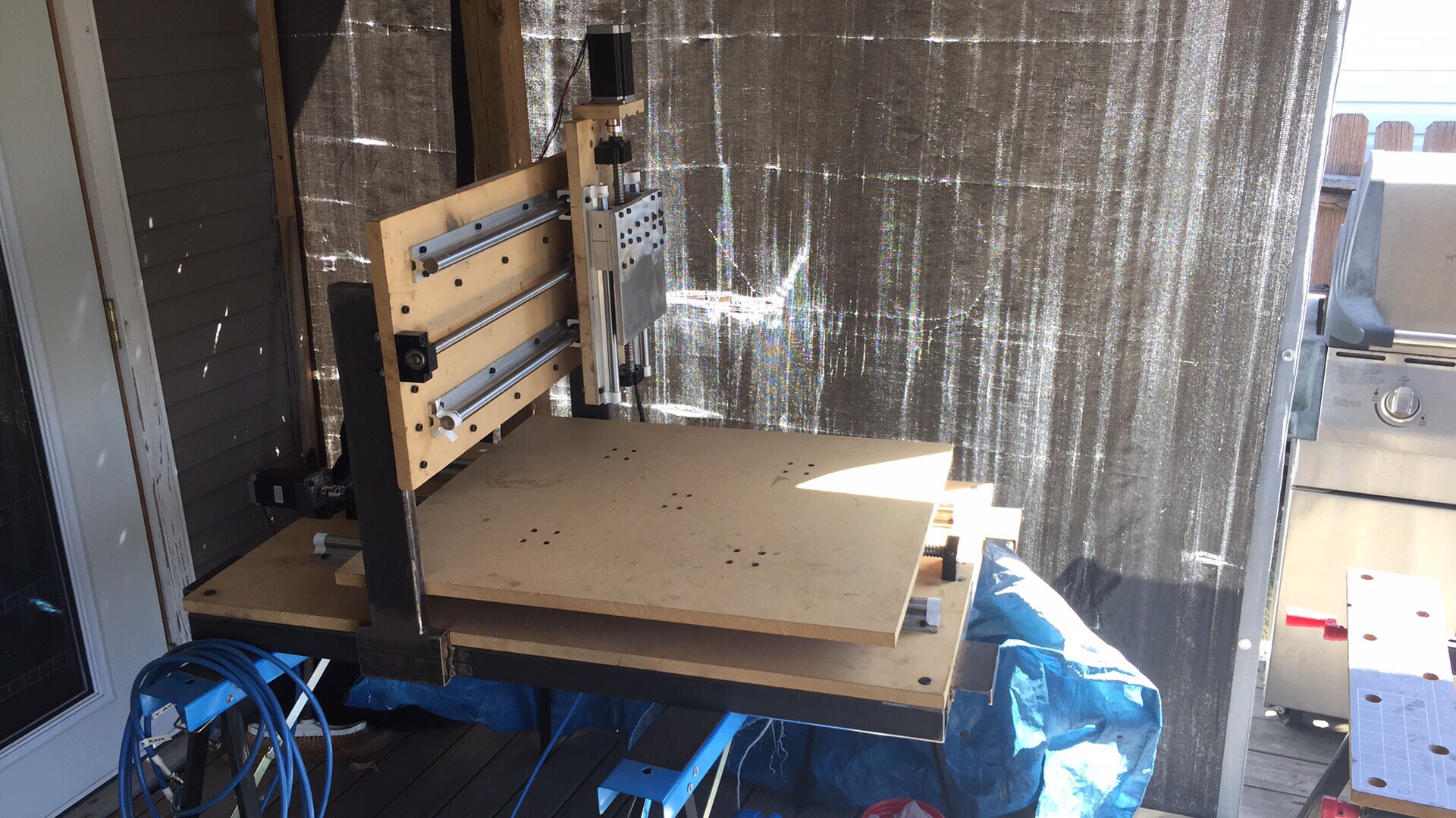

All axis move!
Now working on router mount and limit switches

@1111120 Will do! Iβve posted a picture with the router mounted on, done a few cutting attempts, have to check some settings and try it out again tonight, might make a little video of the machine moving if it goes good.

Great build! Are those custom built drag chains for your cables?
What are you using to control the motors? Software?
Colleague, thank you for rating! The working field is 400x210 mm. Cable-laying machine - 40x20 mm. Drivers - DM 542, 4.2A. Interface board - 5 Axis CNC Breakout Board. Engines -18 kg. Mach3.The machine is made for mastering programs and cutting the numbering for the wardrobe β¦ After mastering, the next I plan already out of metal β¦

If only cutting (without engraving) -minute 5 (slowly, at low speed, 4 mm acrylic, single-milling cutter).
I wrote 2 control programs (processing strategies) in ArtKam. For engraving, my programs, because there is another cutter.
