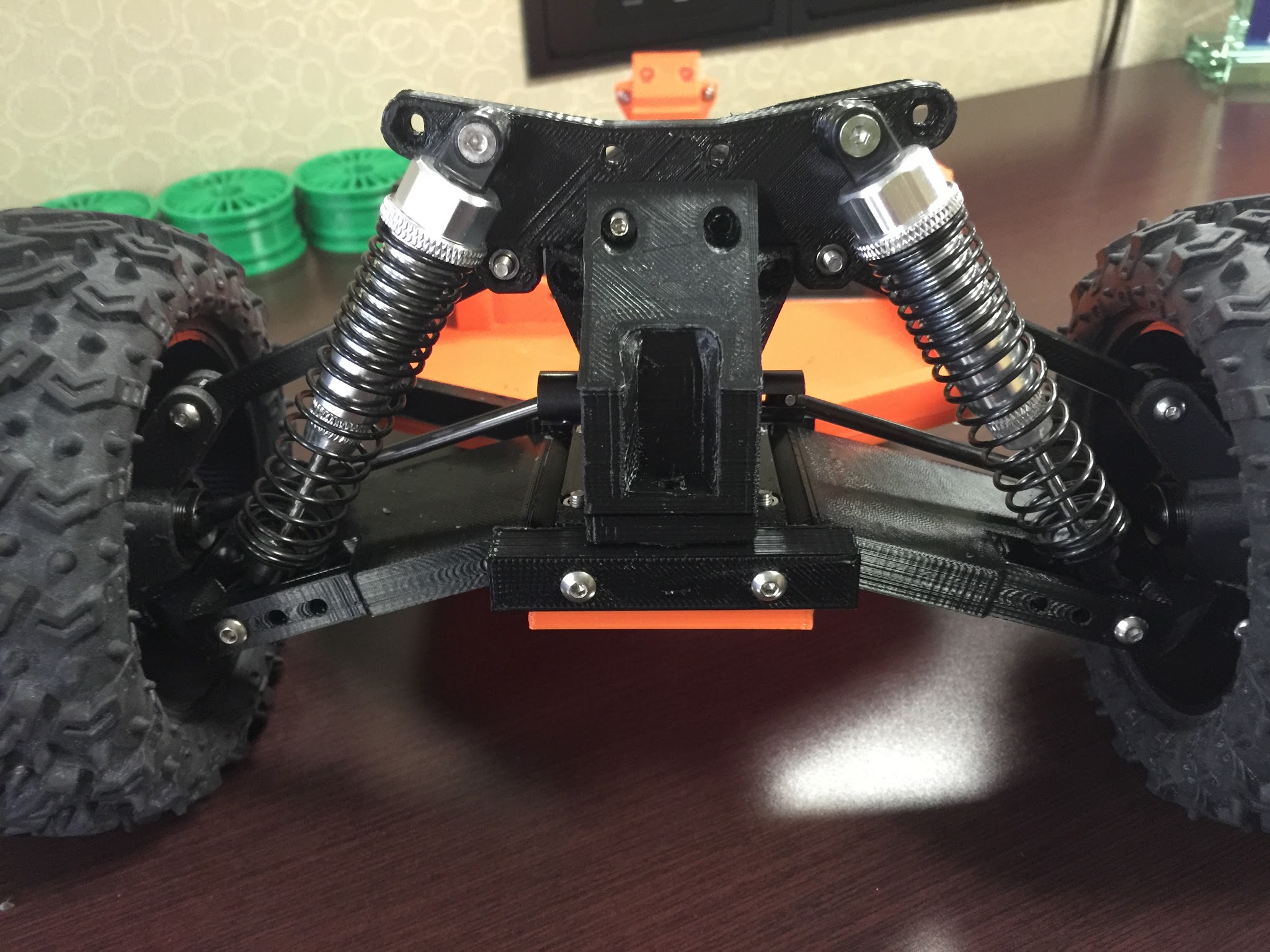

I think I have the rear end complete. It’s definitely a challenge with the shorter wishbone a-arms. The shocks are the same length, but have less travel with the shorter a-arms. Seems like it will work though.
I received the central differential today. I just need to find my fast eddy package of bearings…
What do you think?

Hi, @Francisco_Blanco I’m using these CVD’s from HobbyKing:
Front CVD - 1/10 Quanum Vandal 4WD Racing Buggy (2pcs)
Product # 382000124
$5.95 for a pair of them.
Hi, @bcrazycramer , did you manage to use thsse without frame modification, especially length of wishbones? Thnx.
Hi @Roland_Barenbrug , Yes, I used the those shorter wishbones and they seem to work. I haven’t really used it much, but the day I did out on the pavement was fun. I’m not really happy with the limited movement on the front suspension, but I haven’t found an alternative.
