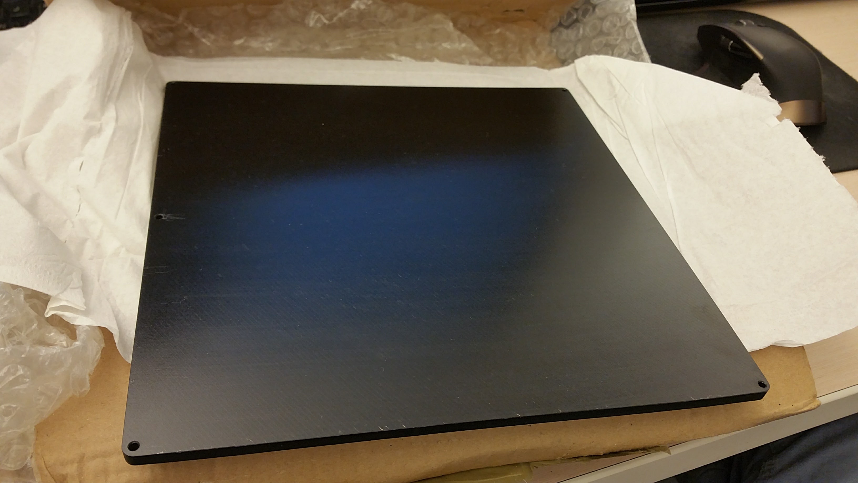

Almost forgot I have this PEI Dauerdruckplatten? straight from Germany.
Almost forgot I have this PEI Dauerdruckplatten? straight from Germany. As far as I know, no one makes this here in US. I purchased some from the seller and he gave me this black one for free. “Courtesy of Frank” so other can try it.
technically it’s mine but it’s not mine to keep :slight_smile: so any ideas how I can pass this on to anyone interested to try this plate? I think I should keep this to US only :slight_smile: thx
The plate fits regular i3 setup y carriage mounting hole

Is it a solid chunk of PEI or PEI laminated onto something? It almost looks solid, but I thought it was almost always used as a top layer laminate.
@Aaron_Spaulding Good point.
It’s a very flat aluminium plate with a thin layer of PEI. The PEI is bonded in a way that it will stay stuck to the aluminium. I have crashed my nozzle several times into the Dauerdruckplatte but the PEI layer is still intact.

I don’t think “layer” of PEI is appropriate to decribe the plate. Google translate gives you “impregnated” with PEI. I don’t exactly know the treatment process but there are no layer to peel here and you use them as is. It’s a solid aluminum.
Would the seller “treat” a custom aluminum plate with this surface treatment?
Very interesting… I wonder if this one is special, or if I just had the wrong idea of how PEI print surfaces usually work.
Layer in the meaning of “layer of paint”. You can even do it yourself by dissolving PEI in dichlormethane and applying it to eloxated aluminium.

There are four mainstream ways to make a PEI bed:
  1. Dissolve PEI in an insanely unpleasant solvent and deposit it directly onto a substrate like aluminum or steel (what the Germans do)
  2. Solid PEI sheet, preferably glass-filled (e.g. Ultem 2300) if you can afford it
  3. Thin (a few mil) adhesive PEI sheet, basically an improved version of Kapton tape (didja know PEI and Kapton are chemically quite similar?)
  4. Laminate a sheet (e.g. 1mm) to a substrate with something along the lines of 3M 468MP tape
The thin self-adhesive sheet is the least durable, but it’s pretty easy and cheap.
