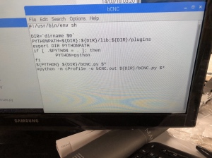

Thank you Alex, so I’ve picked the file you indicated buy now I get this. I guess there is something in there that needs to be changed?
Nope, when you go to open the file, choose open within terminal
