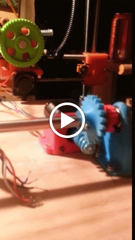

Alright everyone has been asking about z solutions for the ingentis this was the solution I decided on several months ago. I printed it on my then not very well calibrated Mendel big12. Also the STK was 2x to big when I dl’d it from thing diverse and saw wouldn’t recognize features. Do I made the hub and the holes 2x to big and in Cura printed ½ scale. I think Bette can be done and a reduction worm box someone posted is my next try enjoy
