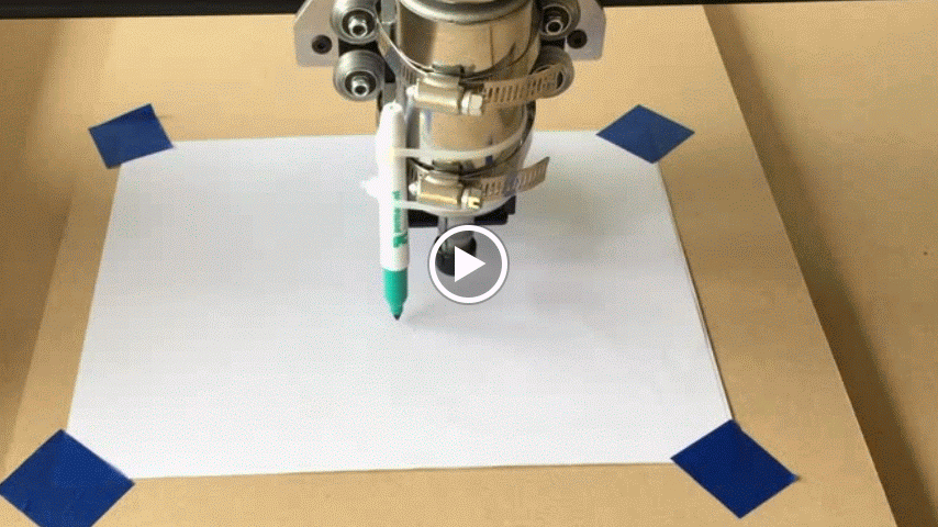

Alright! I got my OX functioning, did a standard Chillipeppr run today.
Alright! I got my OX functioning, did a standard Chillipeppr run today. Still need to fine tune things, add homing switches etc. But I was stoked to see Chillipeppr run a successful Gcode test.
It looks upside down. I’m guessing getting that fixed is part of your fine tuning?
Haha ya I need to “fine tune” the orientation. Seemed like a simple change in the config file just haven’t done it yet.
@jlauer
Fixed the orientation issue was an easy polarity change on the motors. I think my Y axis belts are too tight though. I hear tension when it’s running.
