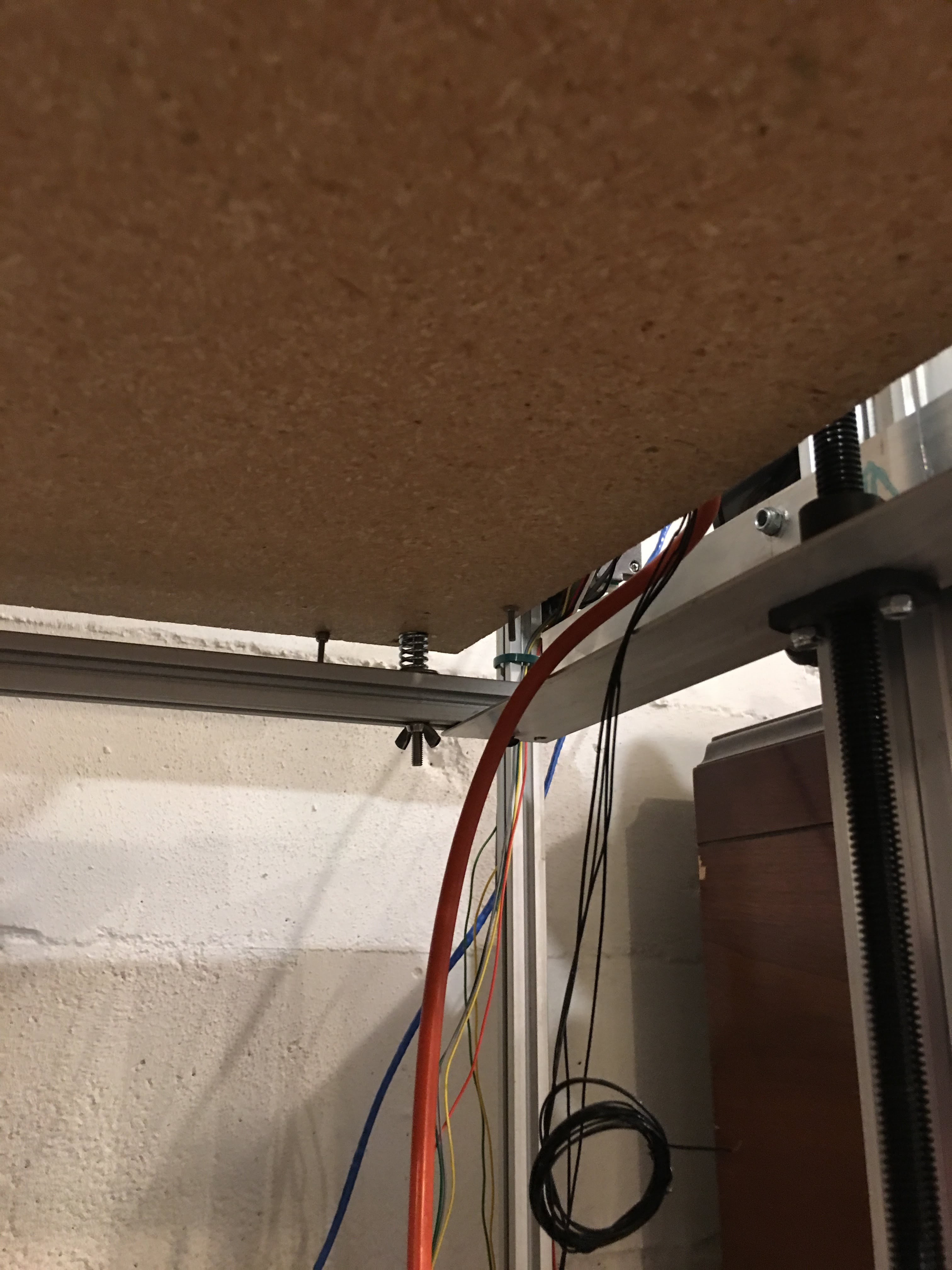

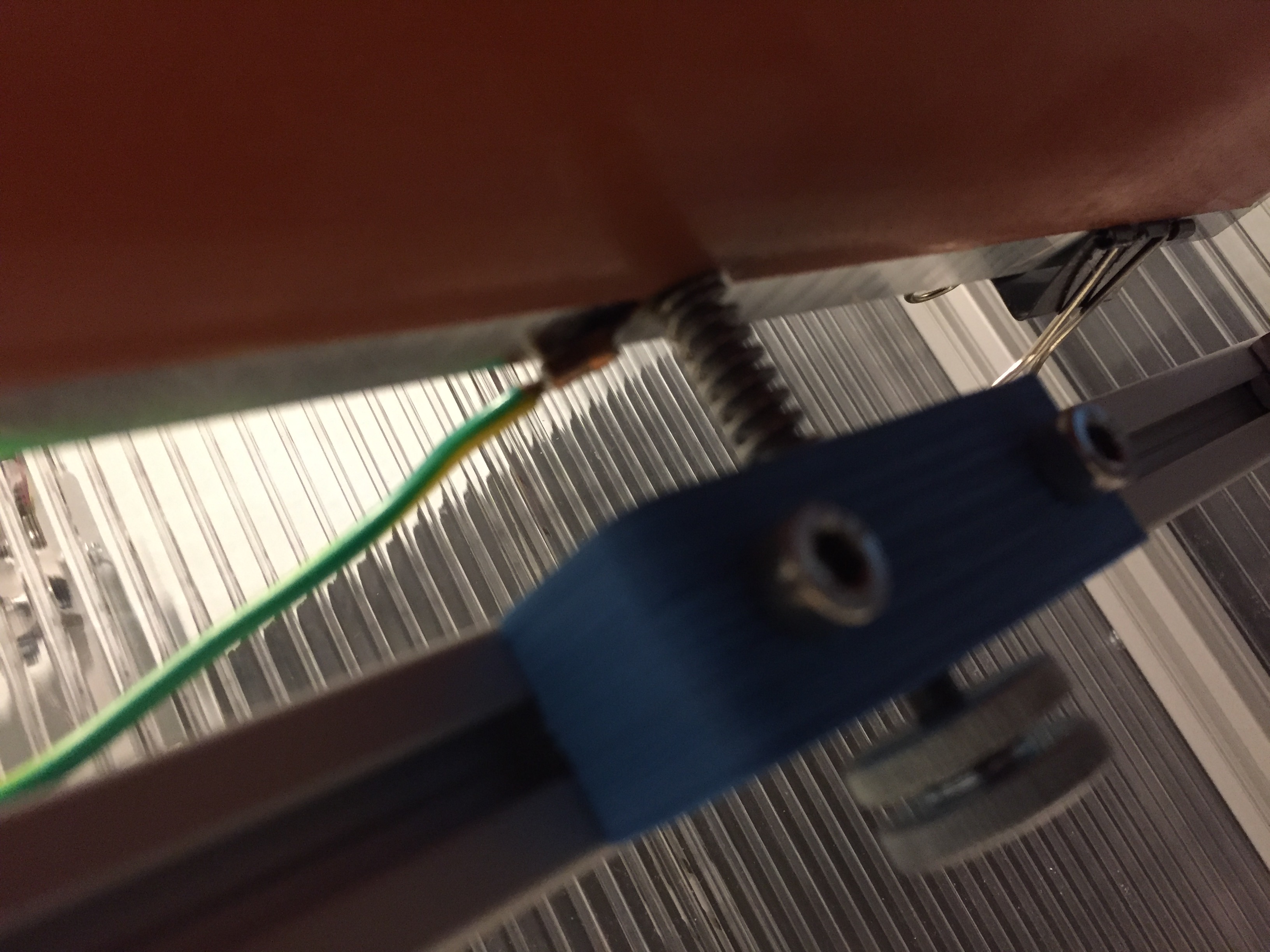

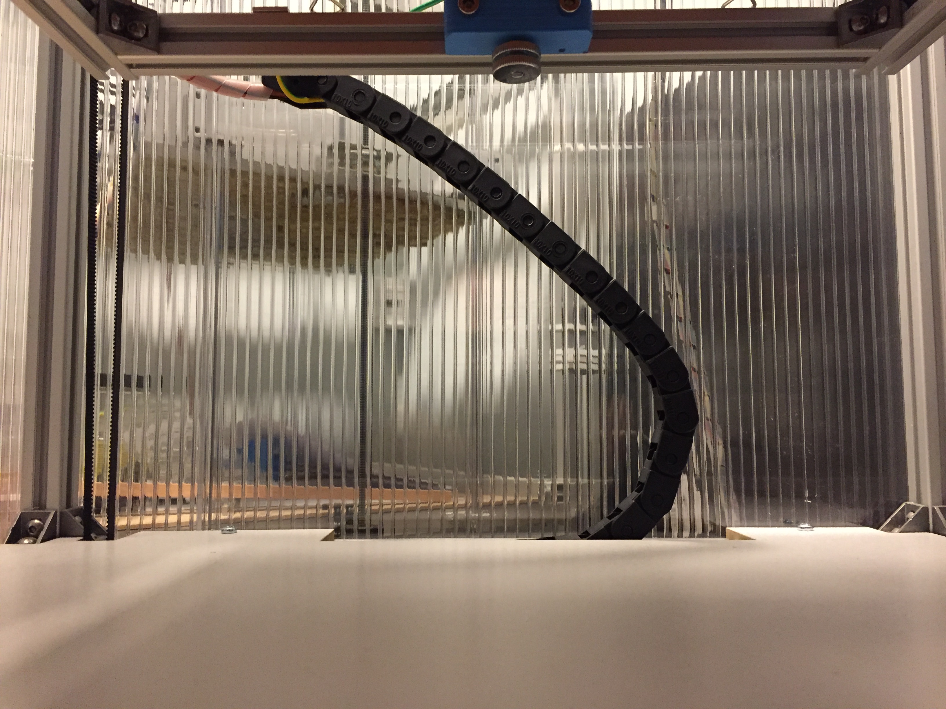

Cable chain in the back, but not from the beginning, I changed it. The cable exit is on the left side, I couldn’t rotate the heater after I stuck it to the plate…
Good to think about it beforehand. If the cable is long enough it’s still possible to route the cable around the bed though, that’s what I had to do. Quite happy with the cable chain in the back, as there are the shafts and rods on the left ang right.
Sounds like the consensus might be routing it out the back. Does anyone have some shots showing how they did it?
