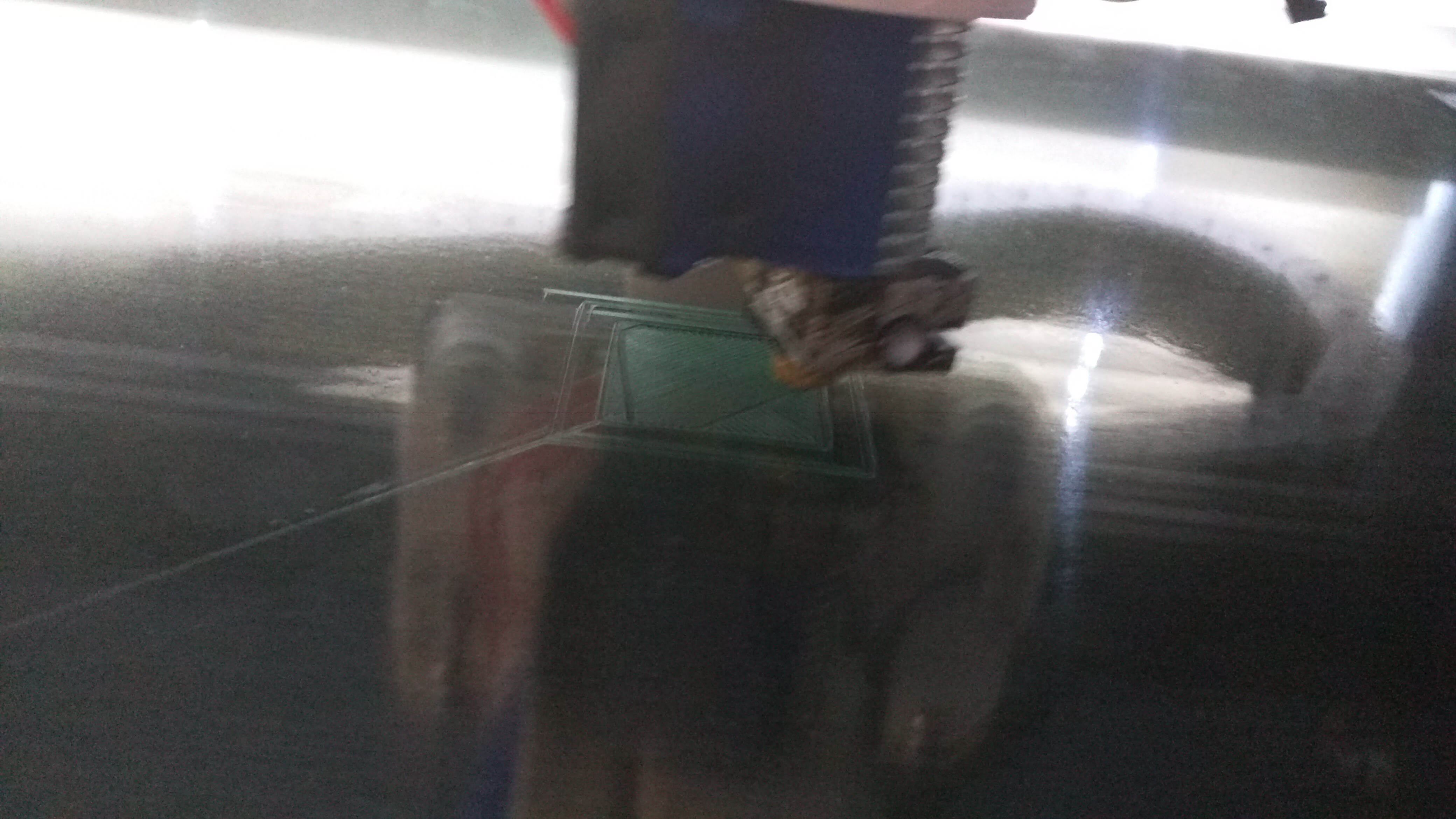

Alright.. well after 5 .1mm layers of printing,
Alright… well after 5 .1mm layers of printing, I have proved the auto bed leveling matrix doesn’t seem to be working with my printer.
Now I kind of expected this as during my test dry prints the nozzle was driven into the bed but I let this go for a few layers to see if it corrected itself. At the bottom left corner, my origin, I can set the nozzle offset with:
G92 Z14.5 ; Compensate probe offset
G0 Z0 F800 ; Move nozzle to the lowest position
I do this directly after probing with a g30 in my g29 macro as seen in my previous post.
That would put my nozzle directly over the bed where I want it at the origin. When my print starts though, by the time my nozzle gets to the center of the bed to begin its first pass its shoved into the bed. If I compensate and add extra height, then anywhere near my origin and other edges of the bed are way high.
I have 8 probe points as seen in my other videos on this page. Any ideas as to why the matrix wouldn’t work with my 8 points?
