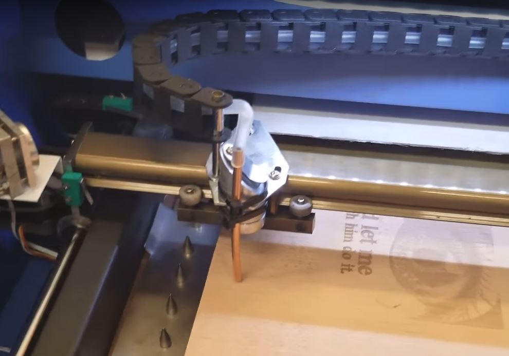

Here is a quick and cheap way to add air assist. If you follow the link on the page to https://k40laser.se/air-assist/ it will explain why this is a better alternative.
Thanks for your response, Like you, after further research I have decided a pipe air assist is a better option for me. The one I have bought uses a part of a stainless steel drinking straw with a 3d printed mounting ring. Will not know how good it is until I run my K40 for the first time. Thanks again.
Yep. You can even get it on Amazon.
