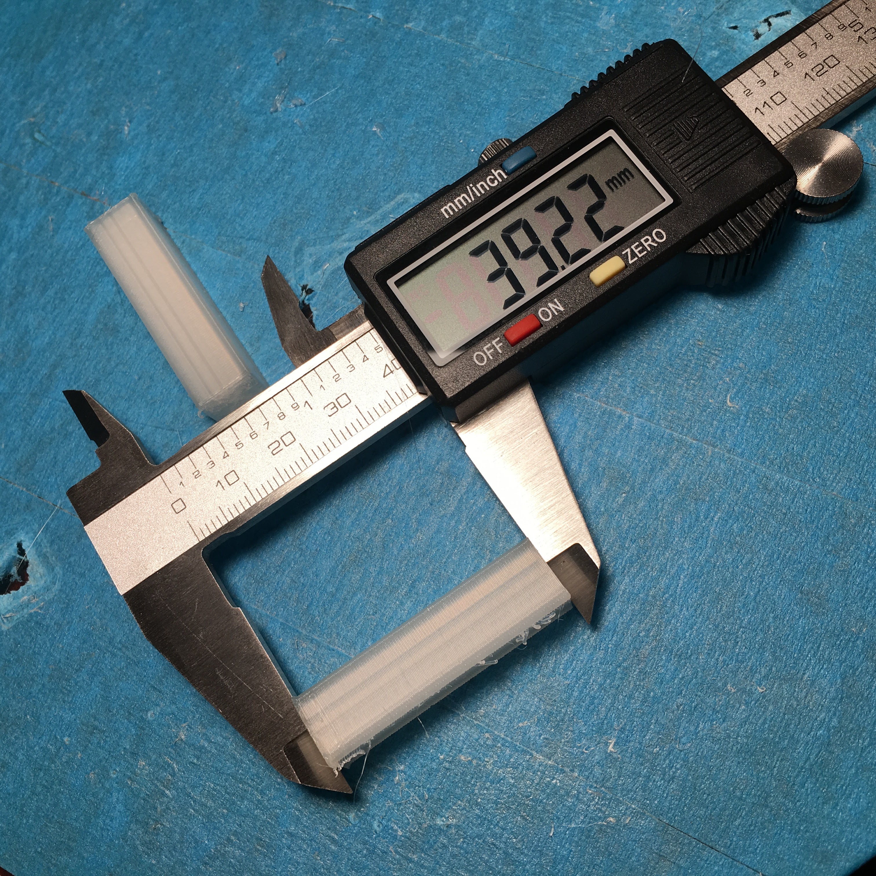

While CraftWare led me to David Cushing’s temperature calibration cuboid, the 100mm height comes ~0.9mm short, raising the question whether Ares has a Z shortage. (Sign in - Google Accounts) So, the 40mm height is an opportunity to test Ares’ vertical accuracy again. The first picture reveals a 0.8mm shortage from 40mm, even more serious than with the 100mm-tall cuboid.
