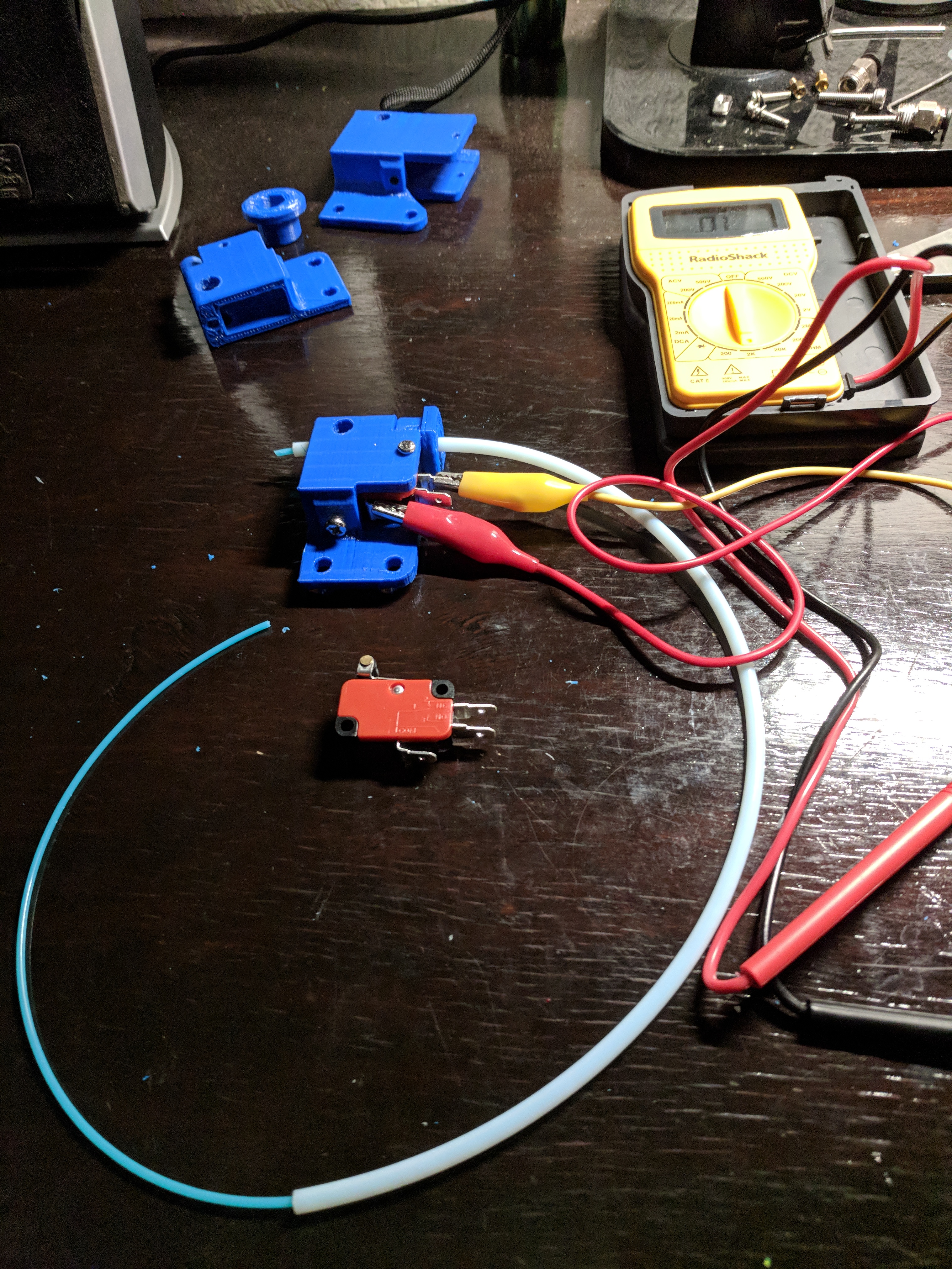

For me, filament-out is my most common problem, so my first interest. And this approach is simple to add to all my printers.

FWIW, this one seems to work. The diameter of side hole/guide for drilling a notch in the tube is the tricky bit.
