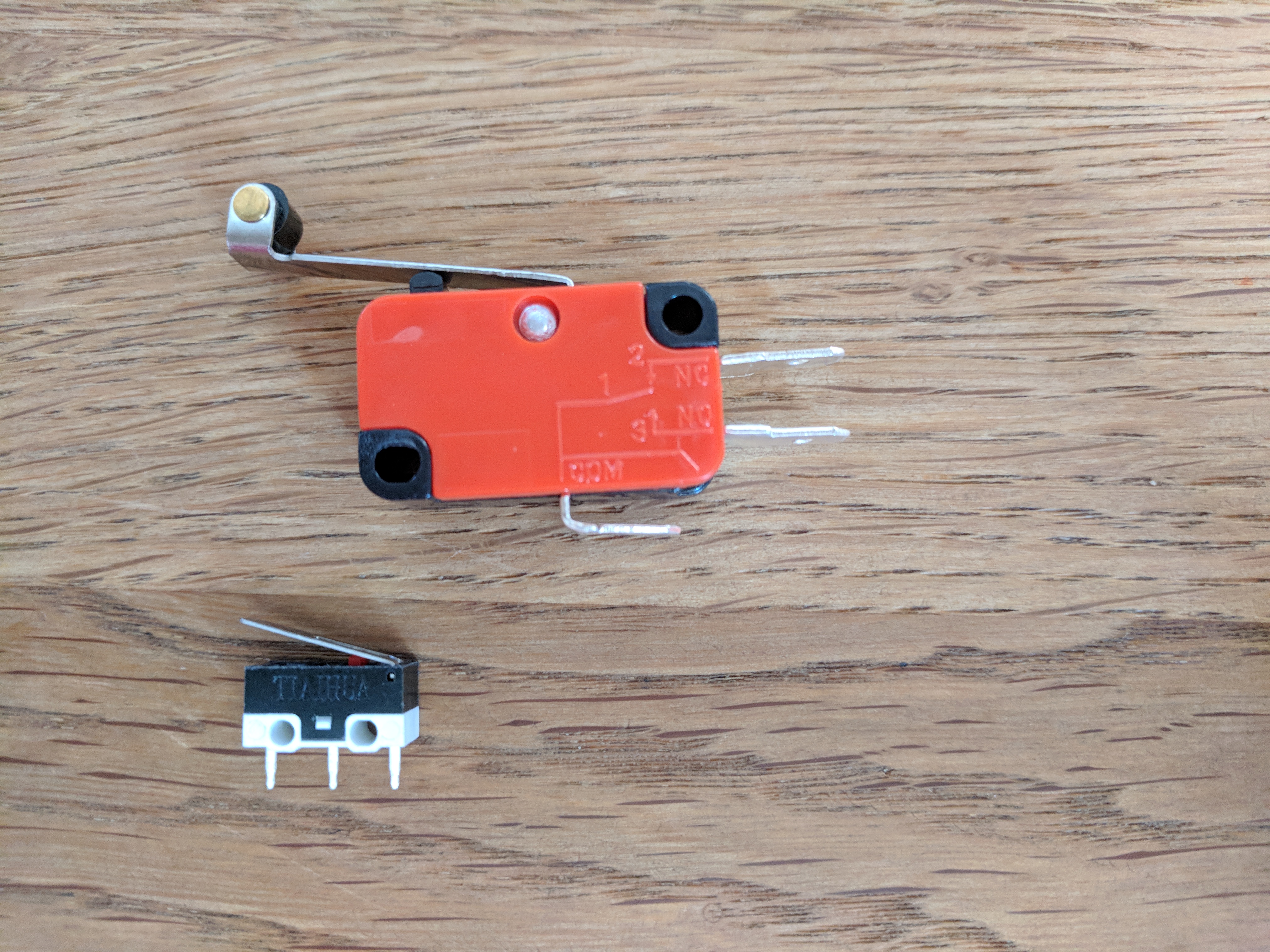

First, clearly I do not know how to spec a limit switch. Got limit switches off Amazon by searching on “limit switch” and buying a couple likely looking popular choices (not having other criteria).

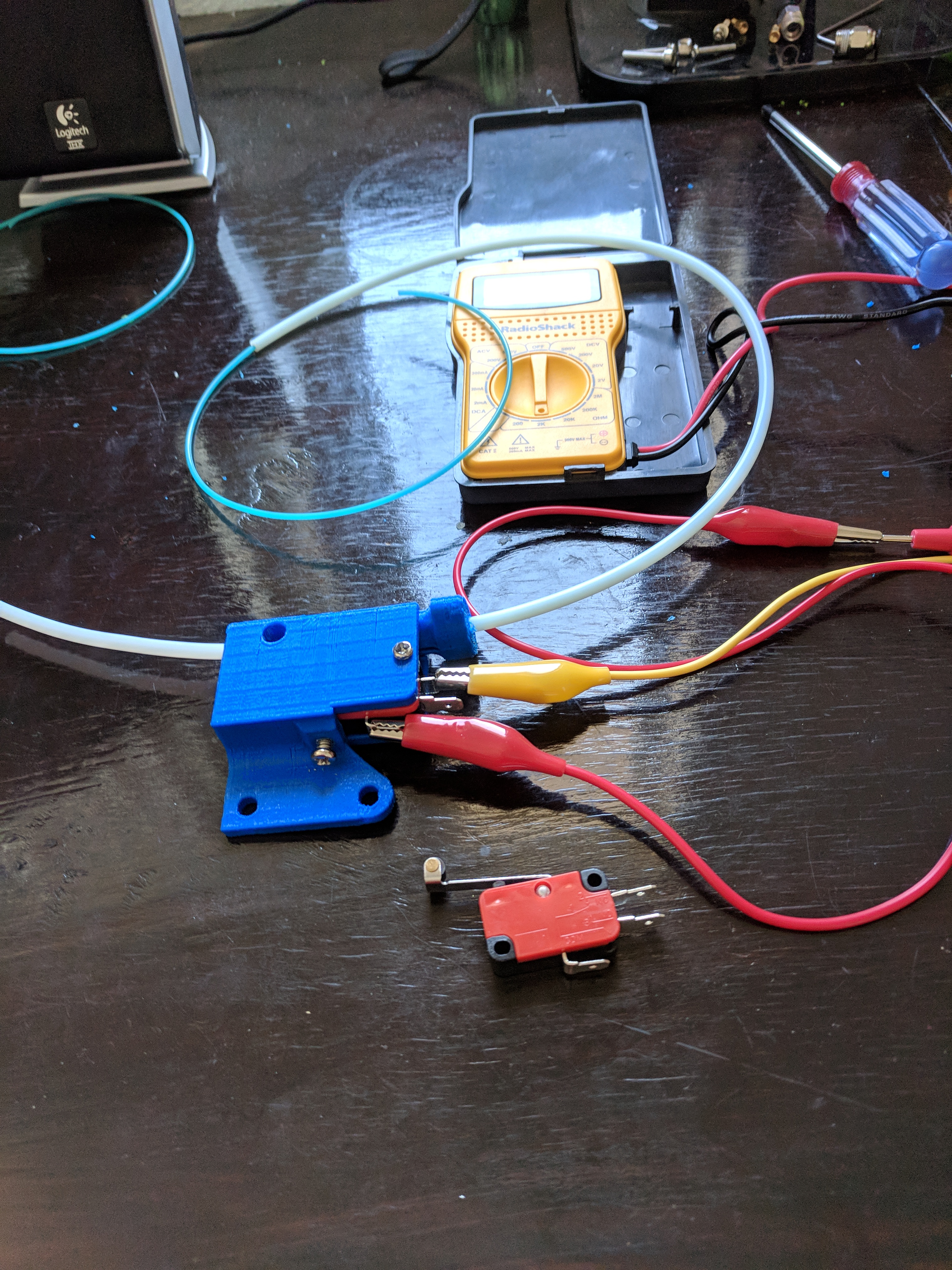

The below is meant to be a minimalist filament-out sensor. The end goal is to detect if filament is physically present, not visual appearance. So a mechanical switch makes more sense than optical, to my mind.
Teflon tube protects moisture-sensitive filaments. Spring in switch presses roller against filament. Hole in side allows visual inspection, and serves as drill guide for putting a notch into the tube for the roller. (Exposure to air only at that notch.) Twist fitting to clamp tube. Adjustment screw to set spacing of switch.
Seemed workable, in theory.
Problem is, this switch needs about 2mm of extra travel to open once closed, and close once open. This extra travel makes sense for many uses, but not so much with 1.75mm filament.
Need to find an appropriate limit switch…

The limit switches I have, at present - too big, and too little for this use, I suspect.

Actually, the ones I ordered are 3 wire (I just checked. But ran a piece of filament into it, it is definately a mechanical switch inside, I can feel the click as it passes by the switch.

Poked around a bit, then ended up ordering the same limit switch, with a shorter arm. Will see if this has short-enough throw.
