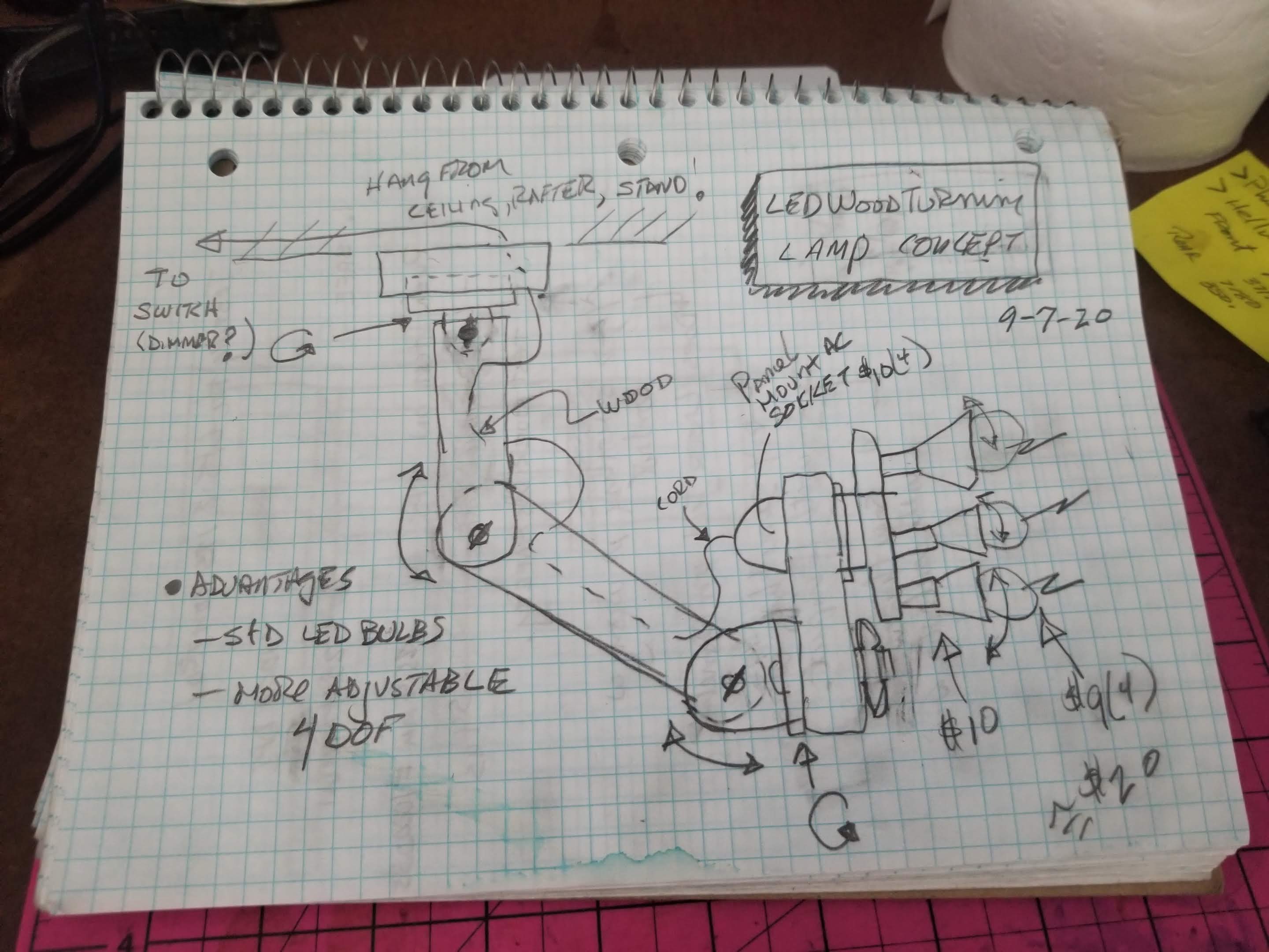

INITIAL CONCEPT
Got refined to this
The key to the design is a slideing carridge that is held in position with the weight of the light cam-ing the back of the carridge againse the slide mount. To slide you lift up on the a light which releases the cam enabling you to slide it into a new horizontal position

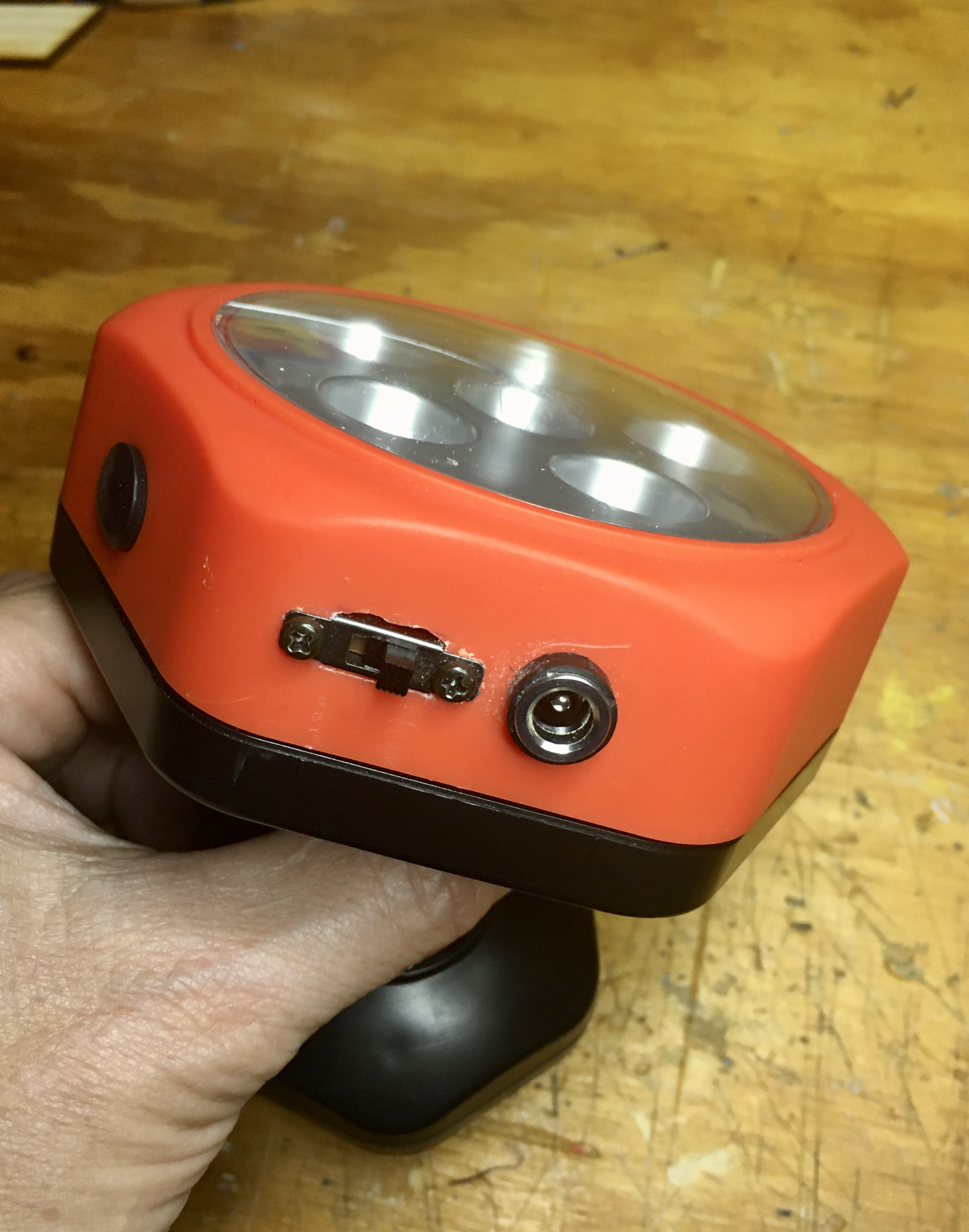

I thought I was doing good when I recently picked up a cheap battery powered articulated led work light, with magnetic base, from HF to add a bit of additional light over my office work bench. Added a power port and switch so I could use line or battery power and added some fender washers over the bench to attach the magnet base to be able to move the light when needed.
You’ve now gotten me wanting my own overengineered work light :slight_smile:

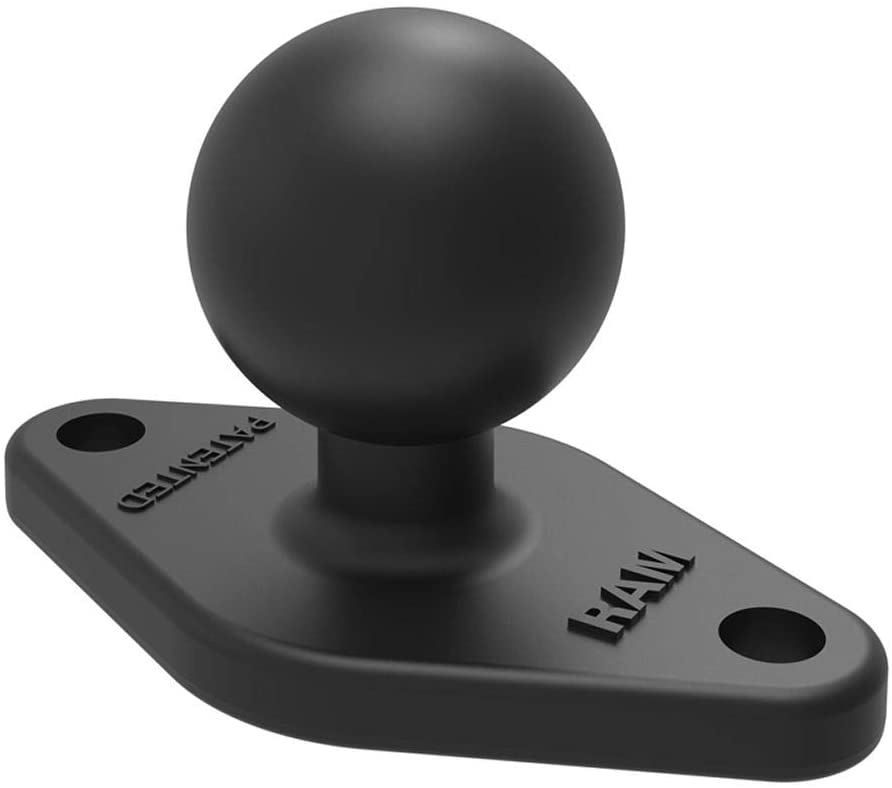

BTW I found these RAM mounts after making the ball :slight_smile:

I like RAM, I have never really had any issues with their items or replacement parts if needed.
