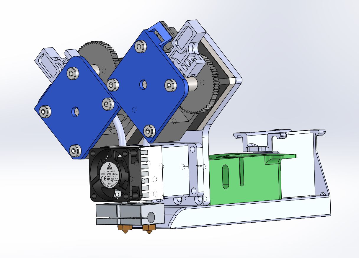

An upgrade of the Dual Felix 3.0 to E3D Titan extruders.
An upgrade of the Dual Felix 3.0 to E3D Titan extruders. I previously designed a mount for the E3D Chimera hot end using the original stepper motors. This design uses two small steppers mounted diagonally on a printed frame. I’ll switch to an aluminum mount plate for the motors after testing.
The next pioneer of 3d fairplay @David_Martin2 !! ;]
“3d fairplay” because I shared my design? @More_Worms
Why would you want to do this?
Looks heavy and large. Why not install a remote direct drive, like the Nimble or such?
Meh. I’m not really a fan of Bowden extruders. This is lighter than the original Felix 3.0 design.
