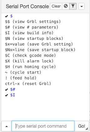

$# and $I are not working for me. Running Chilipeppr/grbl in Chrome on Mac OSX. Everything else is good, but can’t view parameters to edit my WCS’s.

It’s also possible the funnel icon is hiding the response for you.
$# is to view parameter settings for G54-G59 $I is to view info on grbl version
funnel icon meaning filter button? because i tried that before but looks like it just does communications check/scan keeps outputting “ok” every couple of seconds or so
perfect! thanks jarret!
