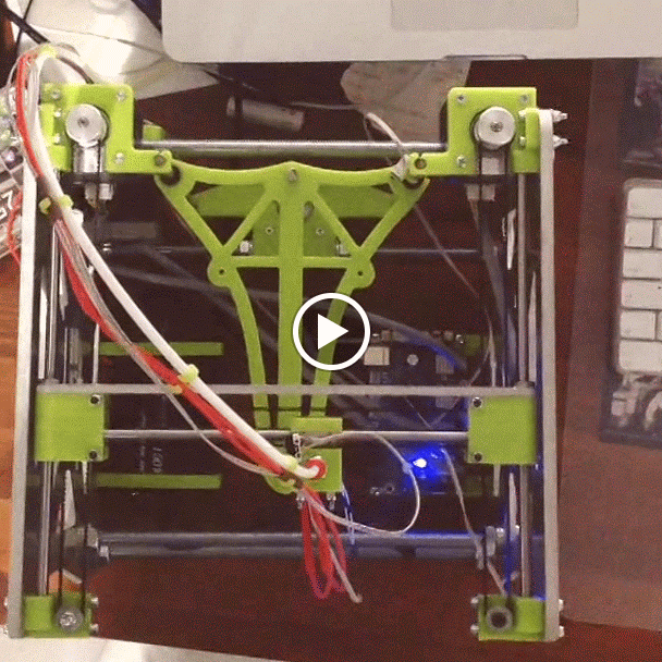

And it moves... The journey begins
And it moves… The journey begins
Is that a core x/y design?
@Stephen_Baird no it’s an H-bot design I believe.
While I think there is some difference between the two, they’re so similar they get lumped together in my head. I’ll be interested to see how yours comes out, though.
I’ve been watching a couple different people on here who are experimenting with variations on that movement system who have been having varying levels of success with it.
I’ve been struggling with an h-bot. I am in the process of redesigning for corexy because racking has proved to much to deal with on my build using standard h-bot design. Let us know how it turns out. Real test is printing cylinders. Check with a caliper after printing. All my circles go football shaped on me.
