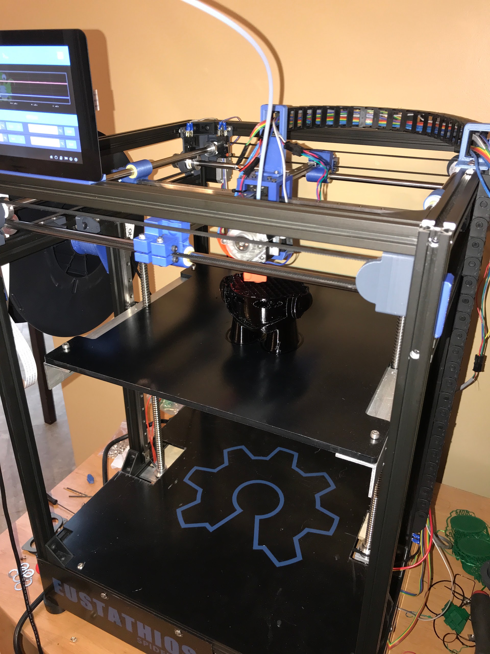

And now that she is pretty much done, here is a Marvin at 500%. Volcano prints are absurdly strong.
Wow. Looking great. exceptional job getting the direct drive extruder on there. and I love the use of Hiwin style rails on the cross rods. You do exceptionally clean work.
Would you mind doing a little photo shot of the changes and upgrades you did to the printer? Perhaps push some of the upgrades out to the github?

Yep. I can push the changes up to the GitHub. I’ll take some photos as soon as I’m done cleaning up. I’m actually reprinting a bunch of the parts like the bearing holders. I had adjusted some of the offsets when I was trying to figure out calibration issues. They weren’t the cause, so I’m going back to stock on those. In addition, the volcano parts are so strong, its unreal.
The biggest changes are the complete redo of Z. Its now metal mounting from the frame to the bed. Its very solid. The PEI plate to print on (its a dream). The extruder setup, rail mount, and X/Y were all changed to accommodate the new setup. Using a BLTouch mounted to calibrate for level. I adapted your spool holder to hold a 3.5 KG roll of filament. And I built the drag chain mounts.
My next goal will be to cut panels to enclose it (sides and top). I’ll get there after halloween
