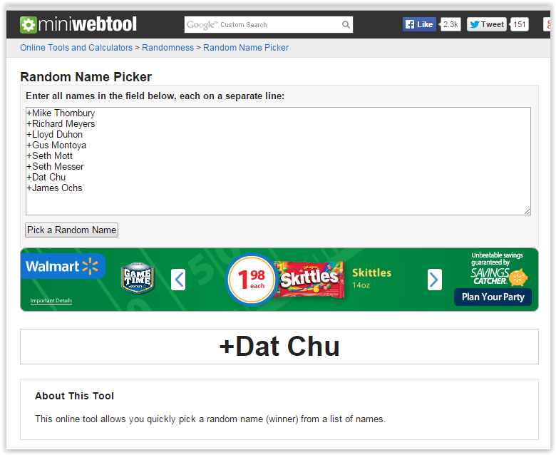

And the winner is: @Dat_Chu
I would like to thank everyone for the interest, and if for some reason I missed a name from the post it was only because If I couldn’t tell explicitly that you were wanting to build, but thought instead your comment was in support of the ideal.
