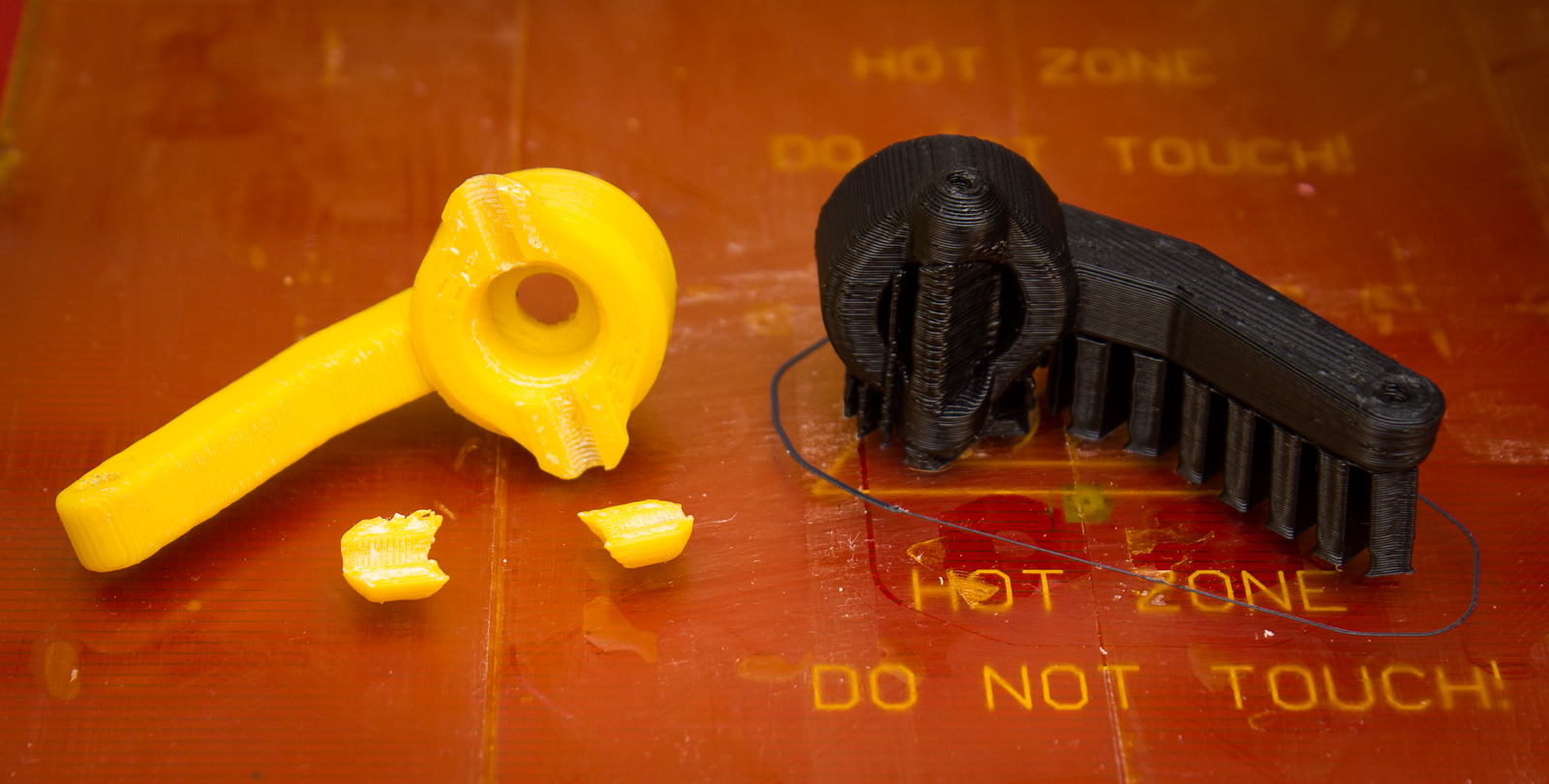

And yet another part broken even before I completed the build - just playing on the carpet with the new wheels on. Clearly I’m doing something wrong. No worries though - I already printed a replacement. This time I put it on a side so the screw holes are stronger and it shouldn’t break.
I’m getting very different results on different rolls of plastic… My prints printed with pink ABS are very durable but the ones printed with my black ABS cracks on assembly… =(
@Szymon_Kobalczyk sounds reasonable, I’m actually sending my black filament back to the vendor, it’s horrible. There must be something wrong with it!
Daniel: Where did you buy this filament?
It´s Makerbot Filament.
