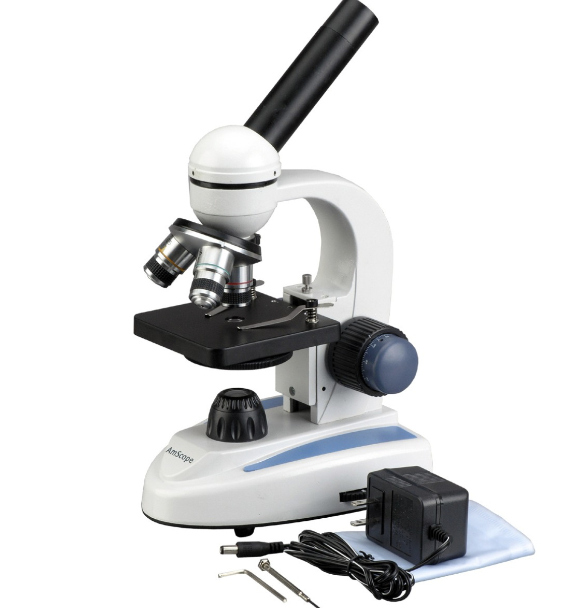

Well, the nozzle changing idea I came up with was inspired by the multi-lens microscope (where three or four lenses are distributed around an axis, mounted on a plate. To change from one to another, one can simply rotate the whole plate so that the lens engaging is pointing towards the object).
See [Fig.1]
