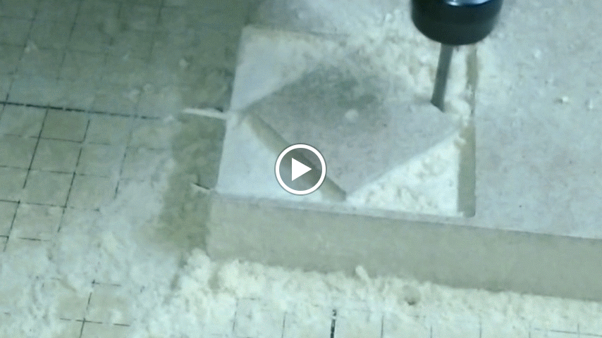

Another new TinyG/Chilipepprsetup up and running. I still have some calibration to do as well as figuring out how to get the PWM spindle control to work with my X-Carve.
