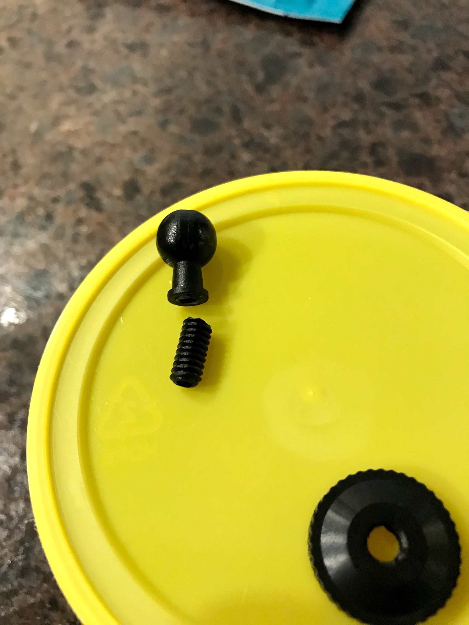

Another practical use for my Reliabuild 3D printer. I had a plastic piece break on a tripod mount for my phone; but I knew what to do! Couldn’t find anything on Thingiverse for it, so I sketched up something quick in CAD and exported it to my RB2 printer. 100% infill to try and make the threaded shaft strong. Turned out great! Maybe I’ll post this on Thingiverse to fill in the gap. @Heath_Harper

@Neal_Grieb I printed this one at .06 layer height, which really helped the threads. Calibrating your filament to your printer does wonders. I’d suggest downloading and printing some of the calibration pieces on Thingiverse. Look up JP1 on Thingiverse and do a calibration print. You can check out this video for how the print should end up. https://youtu.be/0YUTCFqHcTM

The calibration I find most http://useful.is in calibrating the filament per the video above. Simply changing the diameter of the filament slightly in your slicer, cura, or whatever.
