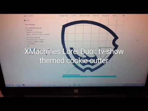

another print over the weekend:
another #XMachines #Lorei print over the weekend:
is there such a thing as food-safe printable plastic?
this print is a cookie cutter, and i’m under the impression that using it for one batch of cookies is fine but after that it’s basically no good anymore.
after the first batch of cookies i’ll plane it down a bit and repurpose as an ink-stamp for my son to play with. but if i could i’d love to make some reusable food-grade stuff.
high temp annealing maybe? something to really close off the small crevices? any ideas out there?

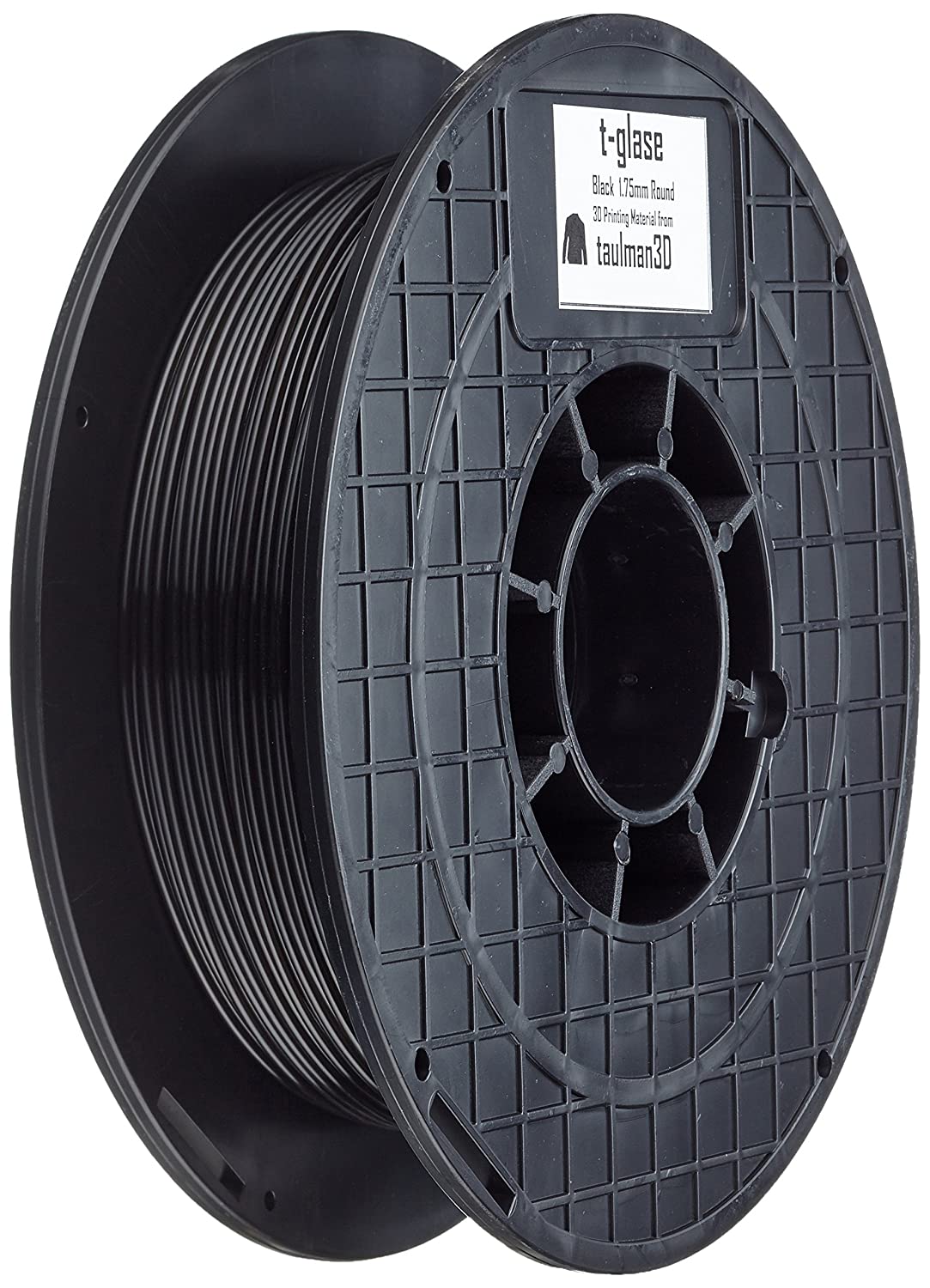

Taulman T-Glase is allegedly FDA approved food safe:
