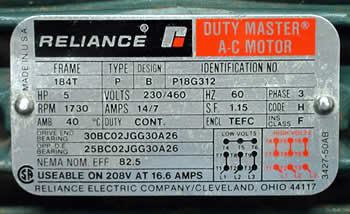

This is a #goodread and unexpected results from my assumptions.
Changing an Induction Motor’s Power Supply Frequency Between 50 and 60Hz
