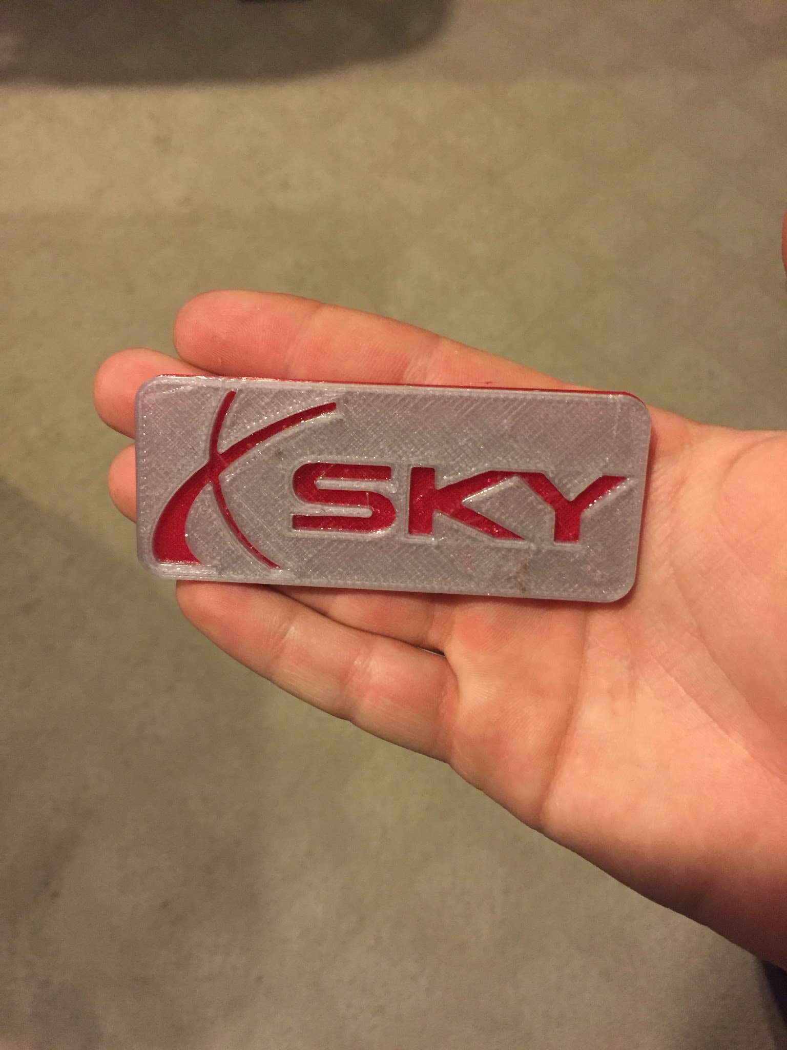

Another two color print.
Another two color print. Just swapped the color halfway through but the red is PETG and silver is pla. Seems to bond well.
Just love the Saturn Sky so I figured I would use it as a logo. Harder to get sued for using dead brands.
Clean! Good idea on the swap too.
Nailed it, nice job.
@Mark_Ellison I also use Cura. What I do is kinda old school but if o have a part that has a definite split, I try to make it X times as thick as my layer height. Then I just watch some tv and when I hear the printer doing the perimeter for the last layer that I want that color, I go over. When it finishes the layer, I pause it in pronterface, home the X and y and then swap the colors and in this case dropped the temp as they were two different materials.
if you submerge it to cold water and then into hot, it pops off, any thermal shock will abuse it, I never mix abs with pla, especially since pla is messy whenever any chemicals are around
