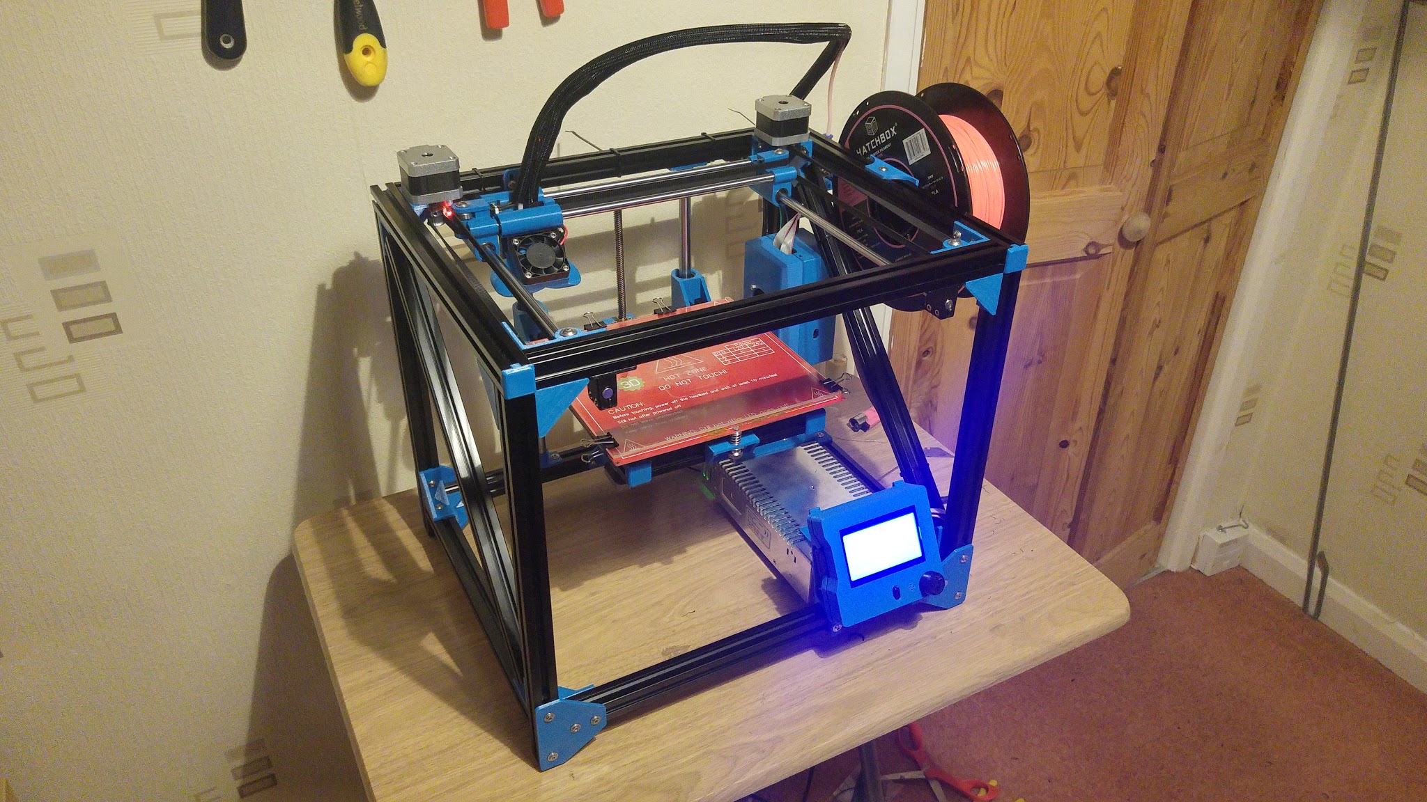

Another under the belt. Built for a customer in company colours.
Another #FB2020 under the belt. Built for a customer in company colours. Upgraded with a hardened nozzle as they want to print abrasives.
Love the Colors!..what kind of resolution can you get out of this printer???
Depends on how it’s built. That particular one will do 0.08mm layers but the XY detail ad extruder resolution is only as good as 1/32 stepping (0.9 degree steppers driven by A4988 drivers at 1/16 stepping). By swapping out the controller, drivers and lead screw it’ll do a lot better. This is the last fully built one I’m doing as I don’t have enough time to get them built as well as the day to day work I have to do. The next batch will be kits only with various options.
