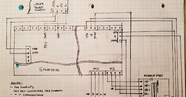

To make things simpler for folks using the “Old” approach that employs Middleman + Smoothie I cobbled together a simplified drawing. Didn’t use pictures yet and sorry for the hand-drawn approach.
I did this fast so if you see anything “weird/wonky/wrong” let me know.
BTW: This config needs an on-board 5V regulator and other DC power configs are possible.
Google Photos
