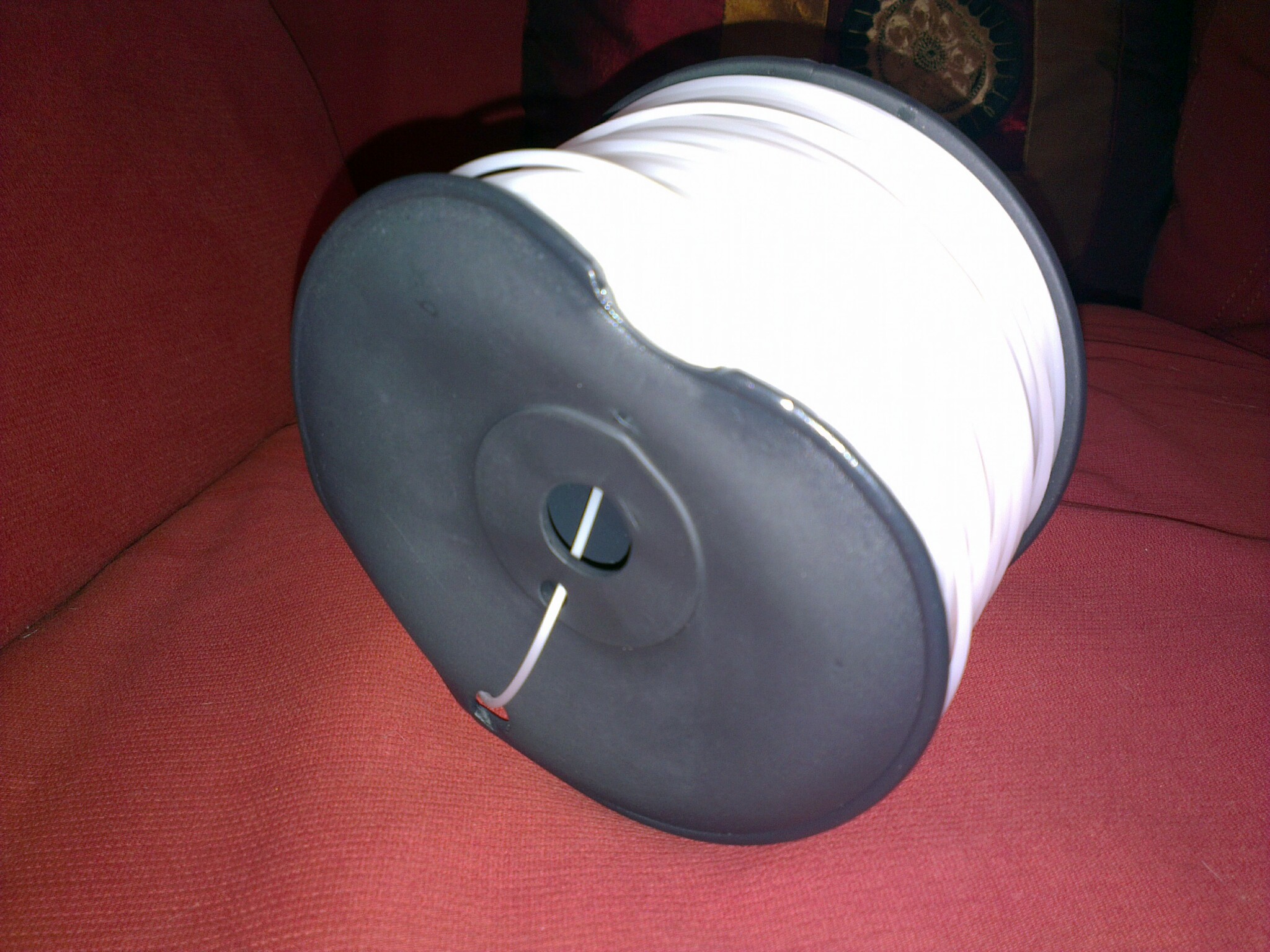

Read some advice saying to “put taulman nylon in the oven for half hour at 50 deg” to dry out any moisture before use…
Another person was saying they’d do it at 100 deg for an hour and, as it turns out, my oven cannot be set below 100… So i took this advice… into the oven it goes at 100 degrees…
Celcius…
EVERY person who talks about 3d printers uses celcius… Except the person who posted this tip… >_<
Turns out 100 Fahrenheit is around 39 degrees c… All makes more sense now - doesn’t unwarp my spool tho does it!? Lol - at least the filament is ok and I noticed the problem early… Could’ve been a bigger problem!
but now is dry as a desert!

Nah it was only in the oven for 10 minutes! The spool itself obviously has a low melting point, I aborted the process early…
