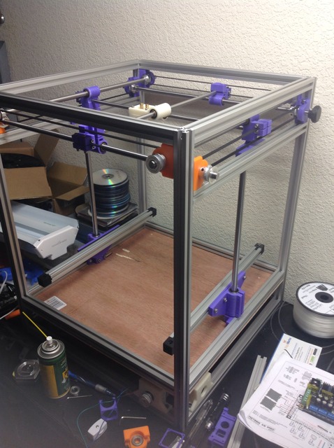

@Anthony_White Here is a picture. Should show what you need to know.
I see - some precise belt trimming is in order that both ends get 1/2 the ridges in mesh with the belt huh?
I’m running my x and y drive belts from the motor up within the frame so I can enclose without as many holes / leaks in the panels. Why are you running them on the outside? Better balance?

I have since switched to direct drive and lost the drive belts. Would be interested to hear more about the board for thermocouple… I am running X3 Pro also.
