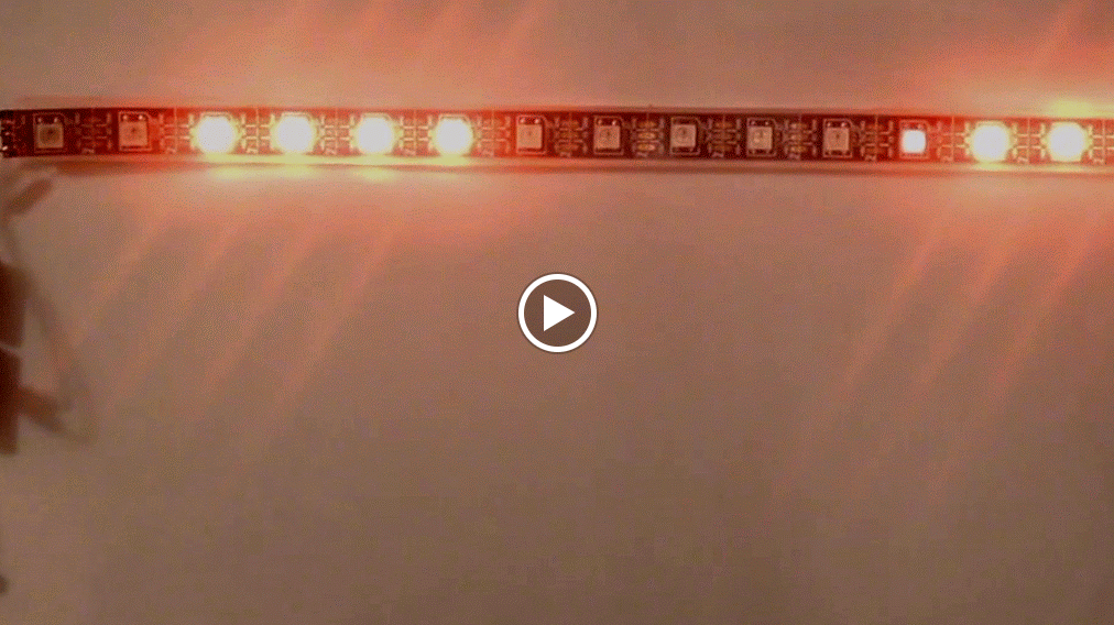

Anti-aliasing example
This example shows two bars of light moving at the same speed down the strip: one using plain integer steps and one using anti-aliased fractional steps.
Code for this example is here: http://pastebin.com/yAgKs0Ay
Notice how even though the two bars are moving at the same speed, one (the ‘fractional’ antialiased one) moves much more smoothly.
… dreaded ‘video processing’ message. No video.
There it is!
Can you see the difference it makes? And after you’ve looked at the code for a bit, does it make sense?

So I’m noticing you are only affecting the first and last pixel of each bar, by going from 0% to 100% (or reverse) in 10% step increments. What about making that longer? As in, say the first and last 5 pixels? Yes I realize that makes the ‘bar’ longer, but I think it looks more natural that way. As one pixel gets brighter, the one next to it starts glowing brighter as well …
Like the way BlinkenLight does it:
This example shows the bare-bones idea of how to do this kind of anti-aliasing. The particular implementation that I did here is just spatial anti-aliasing. There are other (very pleasing!) effects which build on this idea, including the one you mentioned, and I definitely encourage you to play around with it.
The code isn’t doing 10% increments even though my hand-written decimalized example is. The code is doing 6.25% increments (1/16ths). In previous implementations I’ve used a full eight bits for the fractional part of the pixel position, but that forces me to choose between projects with < 256 pixels or using data types larger than 16 bits for my ‘position’ variables. The Q12.4 split here (12 bits of integer, 4 bits of fraction) lets me address up to 4096 pixels. I’ve played around with Q10.6: up to 1024 pixels, with 6 bits (64 levels) of anti-aliased dimming, but it turns out that ATmegas have special instructions for cleaving a byte into two four-bit ‘nybbles’, so the code size and execution speed are much better if everything is 4-bit aligned, as in Q12.4.
If I weren’t such a bit-twiddler I suppose I could use 24-bit (or 32-bit) data types for position values, and get 8-bits of anti-aliasing. On ARM I’d probably go with Q24.8; ARM not only deals with the 32-bit words in a single cycle, but it can also shift an arbitrary number of bits in a single cycle as well.
Anyway, there are lots of fancier effects, as always. This is to get people started with the idea and thinking about what they could do with it – so I think it’s working!
If you really want it to look slick, you code it so you have a faster ramp-up on the brightness at the ‘head’ end of the bar, and a slower ramp-down of the brightness at the ‘tail’ end of the bar, depending on which way it’s moving and how fast. The next effect is not only anti-aliasing but also motion blurring, which makes it look even that much better.
As for the Blinkenlight code, they way they’re doing it doesn’t really scale up. When I’ve done that on larger projects, I’ve done one of two things: EITHER break the ‘draw’ code into three parts: the ramp up, the constant-brightness section in the middle, and the ramp down, so that the constant brightness loop in the middle can be as tight as possible, OR use a fast fixed point function (e.g., cosine, or quadratic in/out easing, both provided in the library) to modulate the brightness along the whole bar. The modulated-brightness options look much more ‘organic’ than the up-hold-down ones at larger scale, and only cost a handful of instructions. In fact, I just compared it, and using the FastLED fixed point cosine function to modulate the brightness along the light bar is actually faster than the code in the Blinkenlight example. (The problem there is that they’re assuming that “abs(…)” is cheap, and that the compiler will make a jump table out of the switch; neither are as right as they probably expect.
